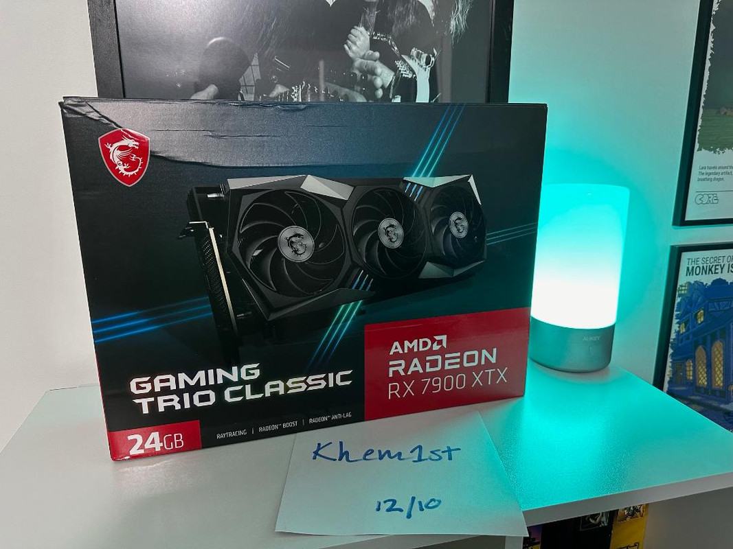

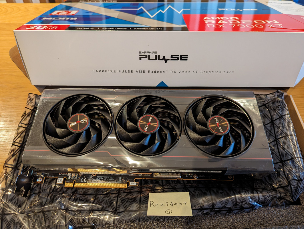

My new baby, these things are huge:

had a bee in my bonnet about buying an 7900 xtx once i had a 7900 xt so have bought one of the msi ones, will see how much faster it is than the pulse 7900 xt, going to put the 7900 xt in my other pc.

Hi all, on a separate note I’ve been offered a MSI gaming classic XTX for a trade with my 4070 Ti (I paid £680 iirc ) + £130. I play at 4k 60 - is it worth it? The Ti does a great job but does struggle at times in resident evil 4 maxed out and far cry 6 where I’ve seen the XTX exceed 100fps
What’s your thoughts on this? Got someone prepared to swap my 4070 Ti +130 for this. His is brand new like mine. Temps good? My Ti is practically silent so would like this to be quiet.
Not had a great deal of time with it yet. Initial impressions are its very quiet but defintly not silent. I played cyberpunk for an hour last night and it never went above 70. My case is NZXT elite which isint the best for airflow anyway.
