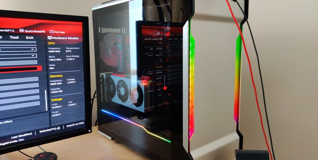

Would never go back to a small chipset fan these days, last I had one was on a Nforce2 chipset I believe, really loud due to the RPM they have to spin at. Any 200W+ card will heat up the chipset. I decided to vertically mount my card for aesthetic reasons, though it did reduce my Samsung NVME SSD + chipset temperatures quite a bit, here's a picture (bad picture due to reflection, but you get the idea :p):
