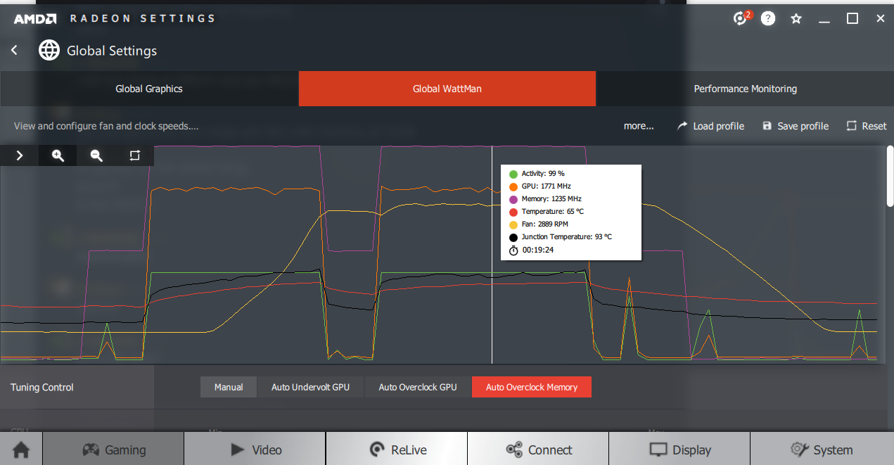

Now unless hbm reporting in wattman is wrong, mine is rock steady at 1235, I can of course post a little shot of wattman as I did some pages back. I did have a first batch ref Vega so am fairly confident that I'm reading the details right.
My HBM slider in Wattman (manual) had a max of 1200Mhz. So your auto is going beyond that!?
Yep I'll share some shots of the card running firestrike in 20 mins :D it basically locks itself to 1771 core and 1235 hbm. That's also on stock fan curve if that is useful.
Cool! Its just a weird one that the auto is going beyond the slider. It shows AMD can more than likely extend the slider range. This will also be a more mature silicone now been 18 months later on the HBM.
so some firestrike and timespy (firestrike top, timespy bottom). These are my clocks leaving everything stock and just hitting auto memory oc:

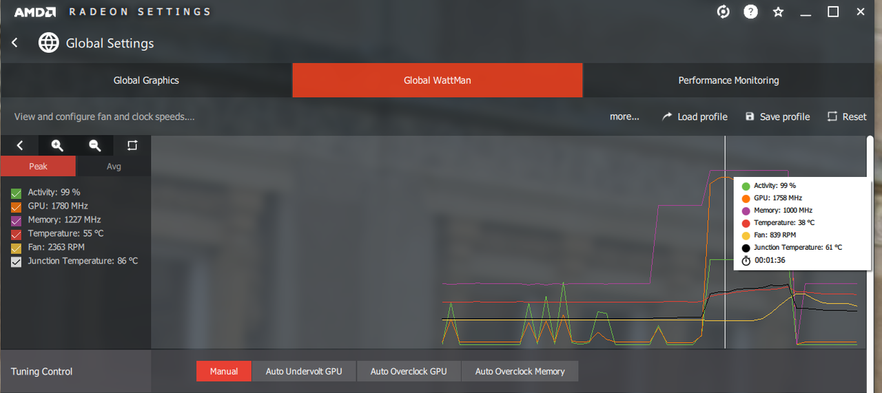

And a reference run undervolted to 950mv
You can see that im doing a custom run with only like 2 scenes but hopefully this gives a decent picture of what my card is all about. My junction temp never seems to go higher than around 95.
That's during a Timespy strees test yesterday. I'd give Fire Strike Ultra Stress Test a go. Your junction will be well over 100C.
