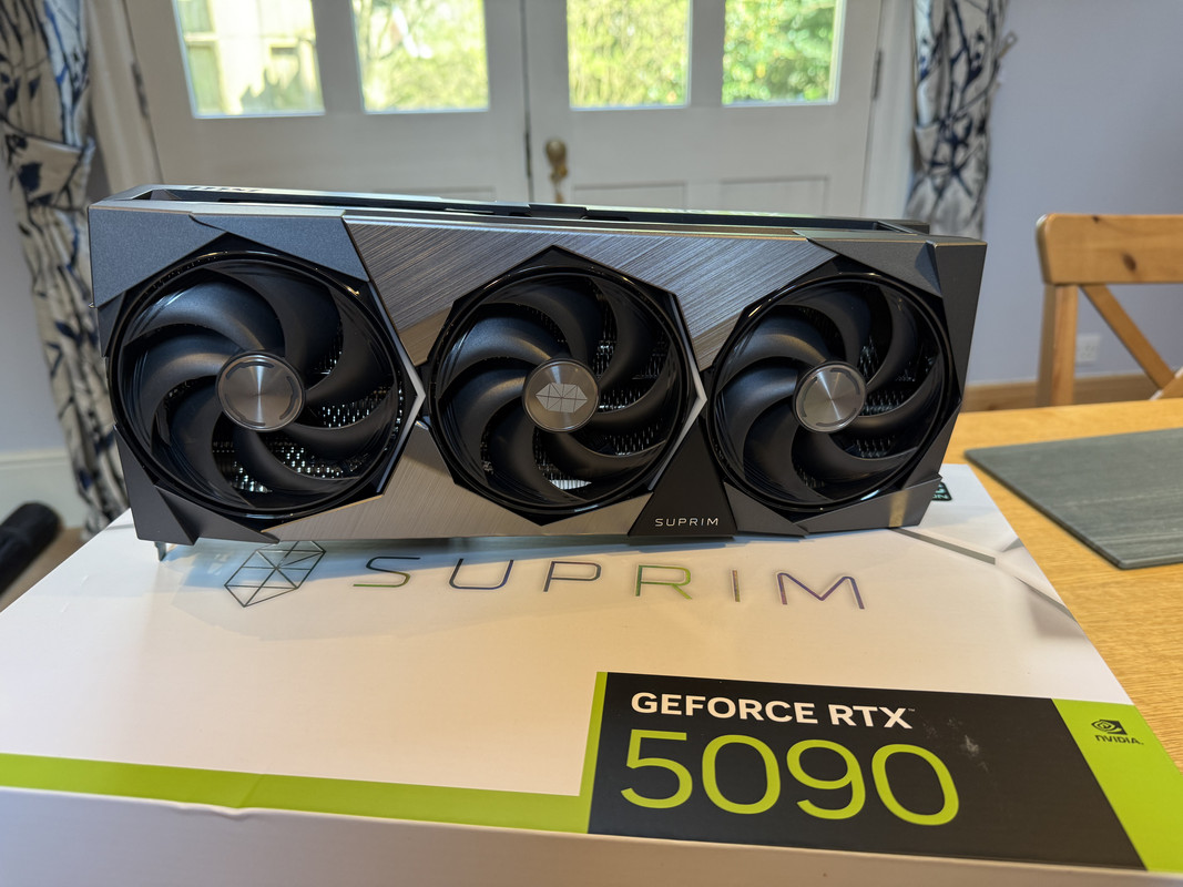

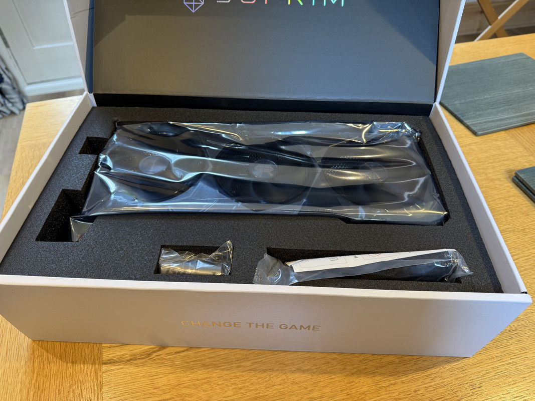

So here it is in all it's glory...
Slightly dented box (not my fault)
Contents; 4 to 1 PCIe to 2x12v HVPWR, a small stand to stop it sagging, and the 5090.
Yes, I know i forgot to take the plastic off the fan centres, sue me.

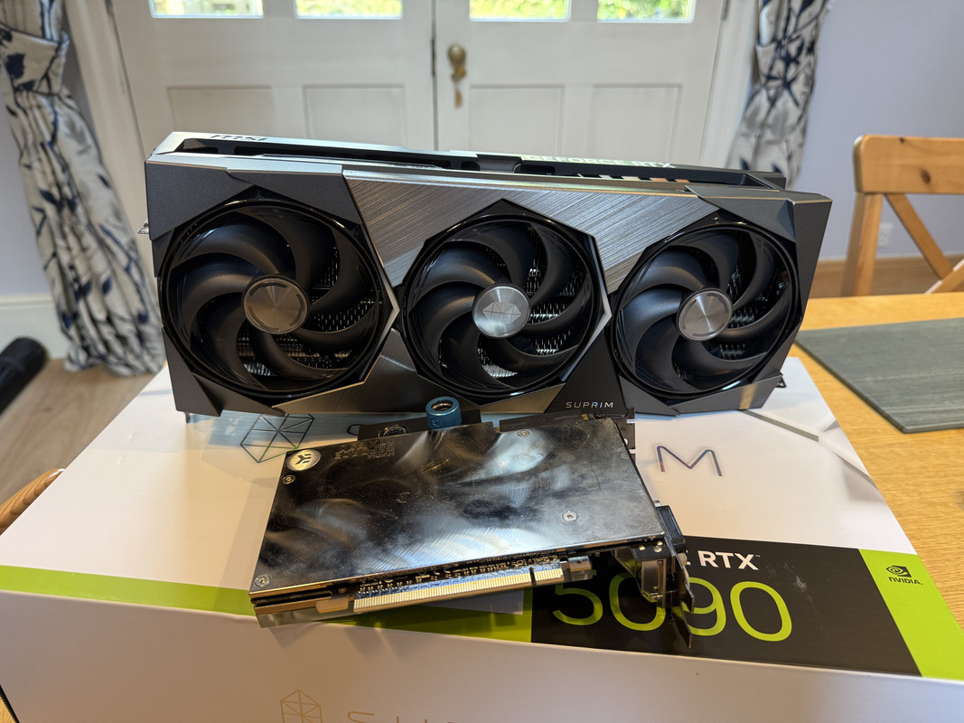

Size comparison with a 970

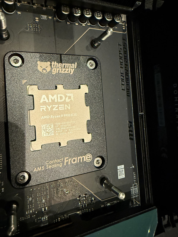

Pretty CPU going in, with new contact plate:

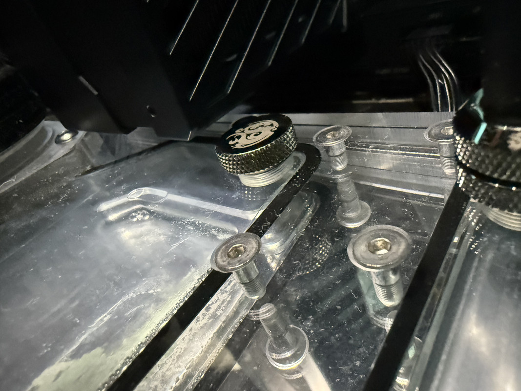

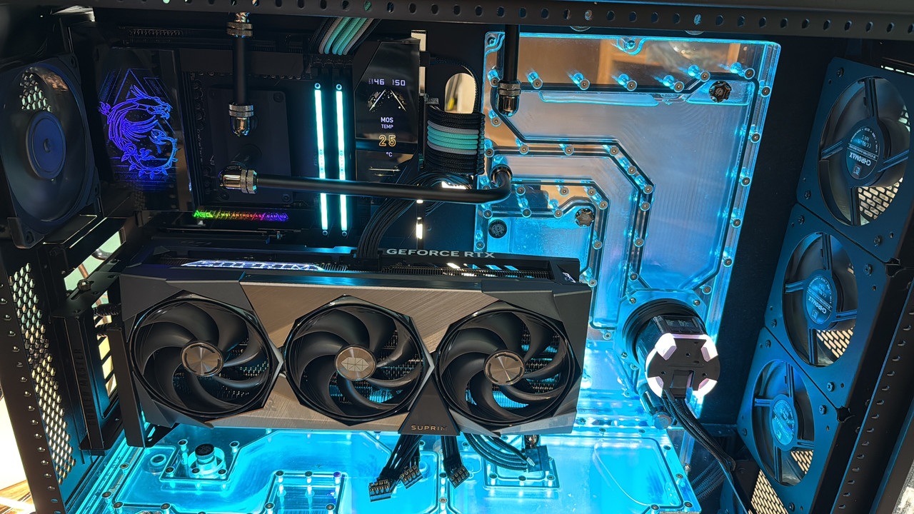

And finally the jankiest install under the sun; the whole back of the case flexes, but I don't want to support it on the distroplate, as if that flexes it breaks the coating on the reflective surface.
I have since removed the PCIe cables from underneath it, I wanted to test the cable temps etc before removing them, but everything seems fine.
Yes there's a massive bubble in the horizontal distro plate, but that's the GPU loop and the pump is currently sitting on my desk so it's just sealed off at the moment.
