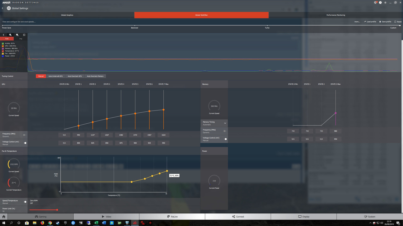

https://i.postimg.cc/fbXgmVjR/wattman1622.jpgThanks. Will try it out at
What are your settings for states other than 7?
Thanks again kind sir
Could you read it? If not try this link: https://postimg.cc/HJY2CshqThanks again kind sir![]()

Thanks.Could you read it? If not try this link: https://postimg.cc/HJY2Cshq

So I did some testing using different profiles I made including yours and dankeeys using Firestrike Ultra Stress Test on 3DMark. I found that his and your one failed a couple of times each to pass (his was like around 91% vs yours being around 94%), but mine passed both times. With dankeeys profile for sure there is more heat and fans have to spin up more. The extra heat eventually means lower clocks that are similar to my profile anyway, so to get the most out of it I would need to run a much more aggressive fan curve and also higher case fans.
I am enjoying my nice a quiet vega that performs better than stock balanced profile. Rather keep it like that and consistently see below 200w being used up than get a little more performance for all the extra heat and noise in the end.

So I decided to give your settings a try and and **** the bed!, FPS performance came out par with my profile of 1652/980/1025mV/50%PL which was 3C hotter and consumed +15W. I was able to better it even further by upping my HBM2 to its max stable 980MHz setting which put it on par between my 1662 and 1772 MHz profiles which are more power hungry and hotter still. This surprised me as my previous testing with lower power limits showed big sacrifices in FPS with PLs below 50%.
I've added the 2 new tests to my table (blue fill) and ranked the 4 metrics; FPS, Power, Temp & Fan Speed. In order to combine the ranks into a single score and find a clear winner, I've weighted the FPS rank by 75% to reflect the higher priority (to me) of this metric - the remaining metrics are summed, multiplied by 25% and added to the FPS score to give an overall score. When the overall score is ranked, the best custom profile to balance performance against power/temp/noise is... wait for it .... 1637/980/1010mV/15%PL. No need for any more "I told you so" now please

Edit2: Further testing on Division 2 last night revealed better performance and lower power/temp with the 1622/980/950mV/50%PL profile than with 1637/980/1010mV/15%PL: 1637 = 64 FPS, 1622 = 68 FPS, 1662 = 69 FPS. So it would appear that there is no single profile that optimises performance/power for all titles and that profiles will need to be tested against each new title to find the best one.
Same as your frequencies. But for voltage I start from 960 and drop by 10 for each state. 50% power limit and 900mhz on hbm.Yeah I'm not finding 1622/950mV/50%PL 100% stable either. Maybe needs a touch more voltage or dropping back to 1617. The tweaking never ends!
Haven't used dankeeys profile enough to know if rock solid yet. Seems good so far though.
So what core frequency have you settled for?
It certainly seems like AMD have been overly conservative with the stock settings. Perhaps they've found a lot of duffers in the binning process so gone for a safe default to keep RMAs down. That said, I haven't heard of many people complaining about not being able to get good results with undervolting so I wonder where the bad cards are?Same as your frequencies. But for voltage I start from 960 and drop by 10 for each state. 50% power limit and 900mhz on hbm.
For some reason I get higher score on the stability test with that. Oh and I found on 960 I get a little bit more performance vs 950 and did not see much difference in temps so stuck with that. If this was new tech and I had more time I would do a lot more testing. But going to stick with this now.
It is mind boggling how with so much less voltage that one can end up with around extra 10% performance and generate a lot less heat and noise vs default settings the card comes with.
