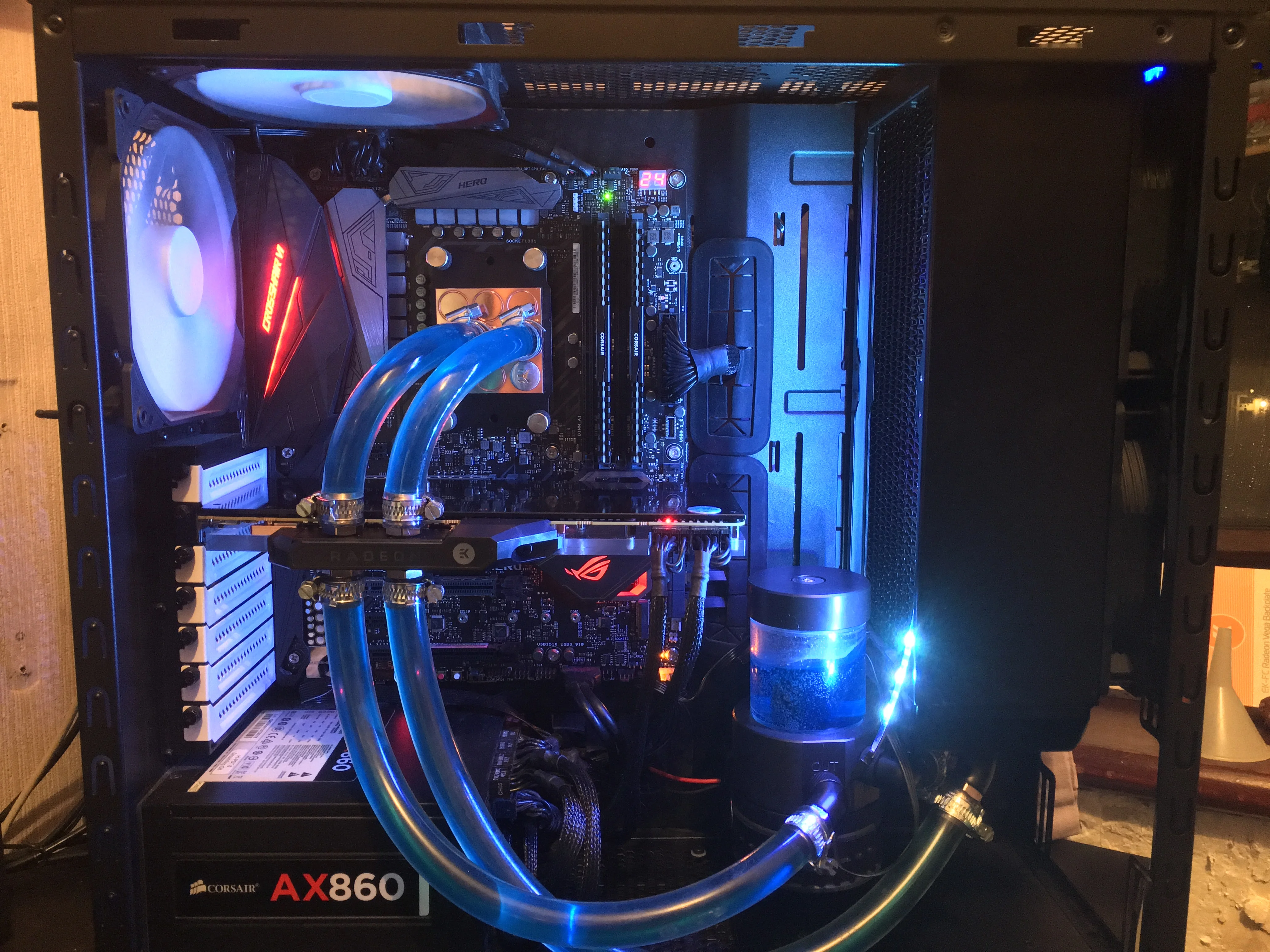

Might be too large.
RGB strip is just used to light the case, and the motherboard accents are always on red for AMD. Coolant will be changed out for red stuff soon, might get a monoblock for the CPU/VRM and i will probably get a larger reservoir tube
Hello,
I had to double take when I saw this loop its not been setup right surely? Should be Res>CPU>GPU>RAD Or Res>RAD>CPU>GPU>RES.
You are going to get much higher temperatures with that setup.
Hello,
nothing wrong with parallel setups.
