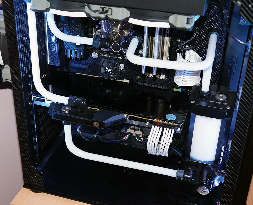

yeah I've tested with the firestrike stress test and got 99.7% and not had any issues in games. I'm using vega 64 bios and card has an EK full cover block on it. Checking max temps lastnight with gpuz after playing PUBG for about 1 hour Core was 43c and HBM and hotspot both 50c.
HMB at 1100mhz and core boost was between 1615 and 1625mhz

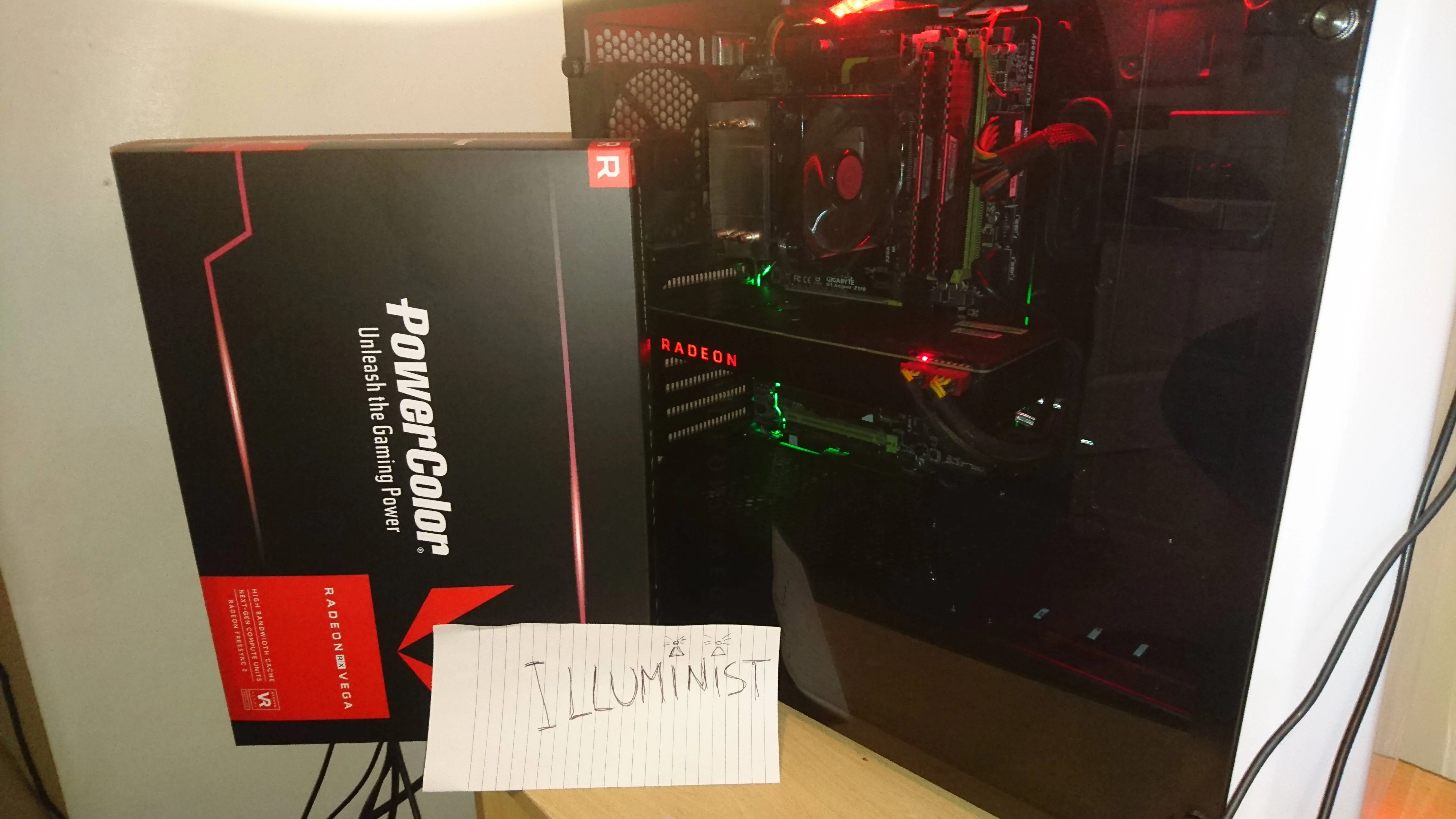

To get on the Roll of Honour all you have to do is post a pic with your user name on it of your Vega 56.
