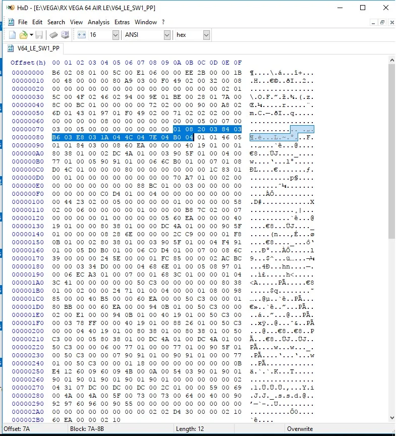

I have no idea fully yet how VEGA is concerning VID/VDDC, but it is not definitely not fixed or as we see when we change to manual voltage in Wattman. I believe VEGA is employing the most advanced "tuning" techniques AMD have at their disposal.
AFAIK V56/V64 when we change to manual mode DPM7 1200mV is pulled from PowerPlay (ATOM_Vega10_Voltage_Lookup_Table).
Code:
7A 00 (0x7Ah)       USHORT usVddcLookupTableOffset;            /* points to ATOM_Vega10_Voltage_Lookup_Table */
typedef struct _ATOM_Vega10_Voltage_Lookup_Table {
01   UCHAR ucRevId;
08   UCHAR ucNumEntries;                                          /* Number of entries */
   ATOM_Vega10_Voltage_Lookup_Record entries[1];             /* Dynamically allocate entries */
} ATOM_Vega10_Voltage_Lookup_Table;
typedef struct _ATOM_Vega10_Voltage_Lookup_Record {
20 03 (800mV)   USHORT usVdd;                                               /* Base voltage */
} ATOM_Vega10_Voltage_Lookup_Record;
84 03 (900mV)   USHORT usVdd;                                               /* Base voltage */
B6 03   USHORT usVdd;                                               /* Base voltage */
E8 03 (1000mV)   USHORT usVdd;                                               /* Base voltage */
1A 04 (1050mV)   USHORT usVdd;                                               /* Base voltage */
4C 04 (1100mV)   USHORT usVdd;                                               /* Base voltage */
7E 04 (1150mV)   USHORT usVdd;                                               /* Base voltage */
B0 04 (1200mV)   USHORT usVdd;                                               /* Base voltage */

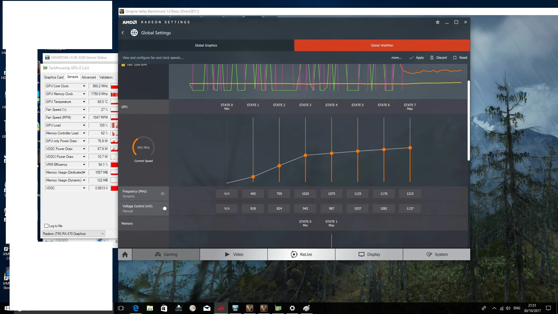

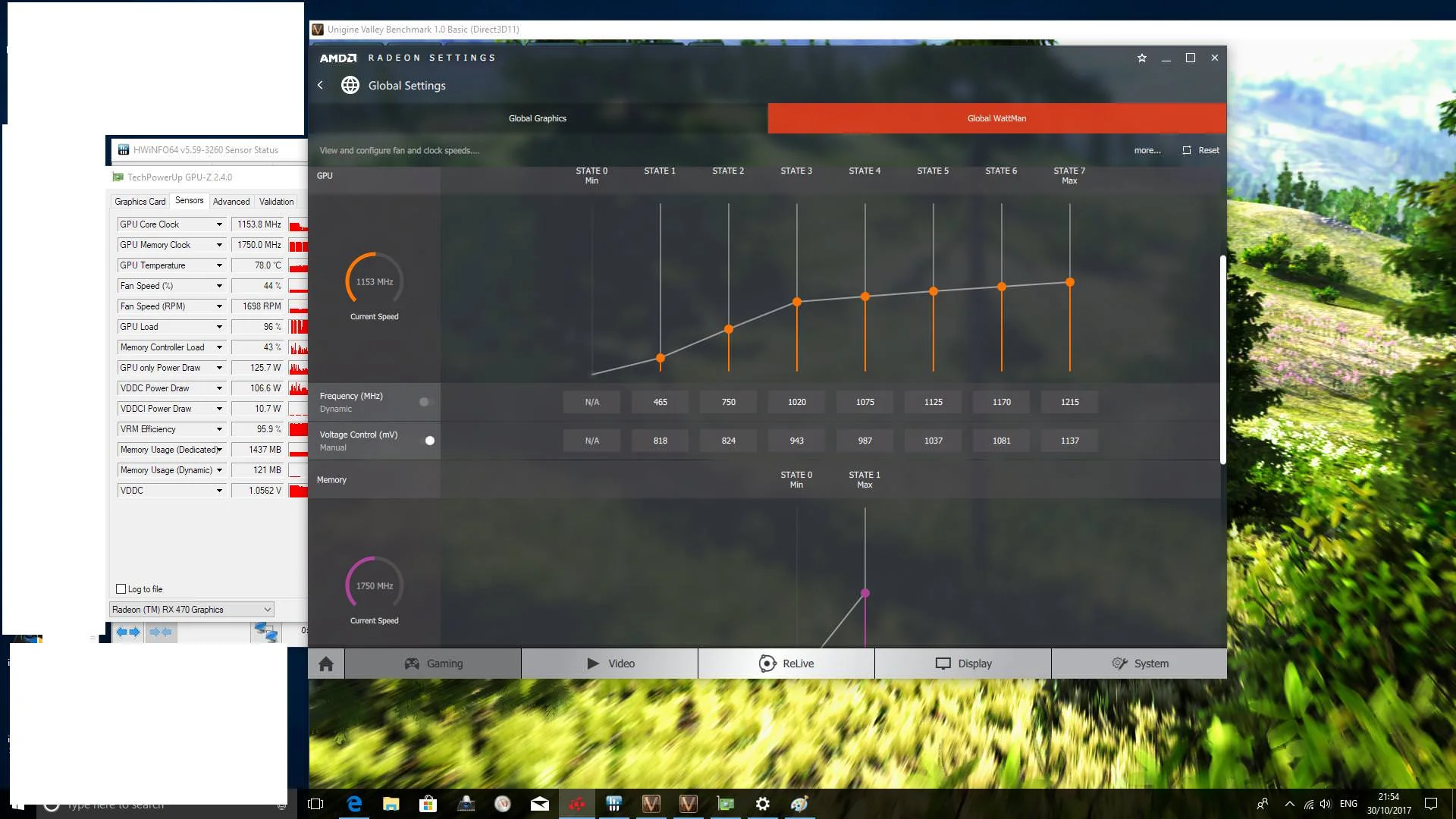

Here's two examples of my rx470, 0% power limit and 15% power limit at auto voltage and auto clocks,
