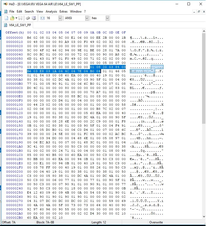

AFAIK V56/V64 when we change to manual mode DPM7 1200mV is pulled from PowerPlay (ATOM_Vega10_Voltage_Lookup_Table).
Code:
7A 00 (0x7Ah)       USHORT usVddcLookupTableOffset;            /* points to ATOM_Vega10_Voltage_Lookup_Table */
typedef struct _ATOM_Vega10_Voltage_Lookup_Table {
01   UCHAR ucRevId;
08   UCHAR ucNumEntries;                                          /* Number of entries */
   ATOM_Vega10_Voltage_Lookup_Record entries[1];             /* Dynamically allocate entries */
} ATOM_Vega10_Voltage_Lookup_Table;
typedef struct _ATOM_Vega10_Voltage_Lookup_Record {
20 03 (800mV)   USHORT usVdd;                                               /* Base voltage */
} ATOM_Vega10_Voltage_Lookup_Record;
84 03 (900mV)   USHORT usVdd;                                               /* Base voltage */
B6 03   USHORT usVdd;                                               /* Base voltage */
E8 03 (1000mV)   USHORT usVdd;                                               /* Base voltage */
1A 04 (1050mV)   USHORT usVdd;                                               /* Base voltage */
4C 04 (1100mV)   USHORT usVdd;                                               /* Base voltage */
7E 04 (1150mV)   USHORT usVdd;                                               /* Base voltage */
B0 04 (1200mV)   USHORT usVdd;                                               /* Base voltage */
Asder00 of Guru3D, famed for providing AMD drivers in the past before release and has helped in Hawaii bios mod (has some tools which can't share ;) ) posted this from VEGA, link.
