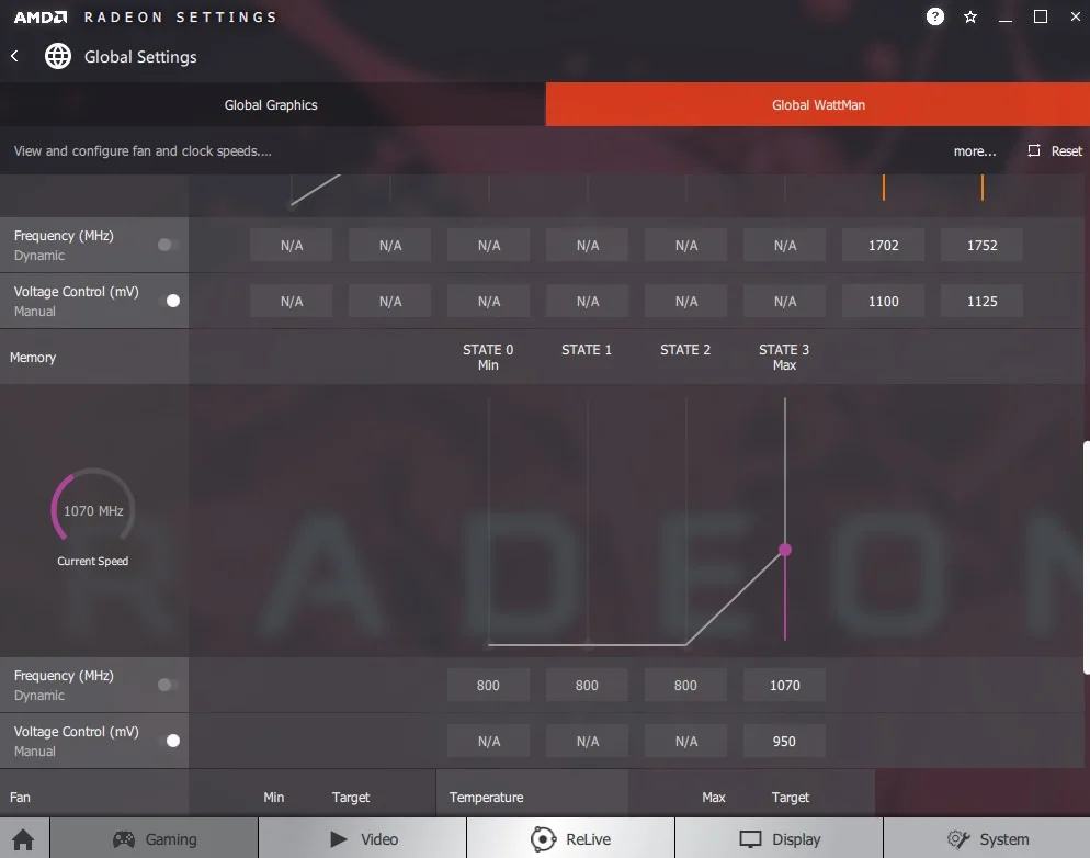

I'd be interested to see if other Vega users can get the following clock, hbm and voltage settings stable, while using whatever the lowest amount of voltage is required to achieve stability. I'd be interested to know what voltage is required to achieve these clocks from AC and LC samples if possible.
With this particular Vega 64 XTX I'm using at the moment, i have achieved the following which is 24/7 stable.
Stock core clocks, but core undervolted 0.075mv. State 6 core clock increased to 1702Mhz.
HBM overclocked to 1070Mhz.
That results in a constant core clock between 1702-1752Mhz.
at work atm so cant test but i reckon i could reach those as i can push 1700 on 1080 undervolt. although i am 56 and not 64.
