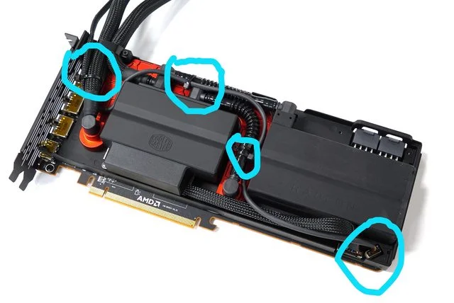

Decided to go for the AIO as well and wanted to change the fan. Would be interested on how easy it is to remove as well, from unboxing vids it looks like you need to remove the shroud first? And then it's also cable tied to some of the tubing:
Pretty sure the shroud can be taken off with the screws on the top and bottom of it. Think there's 4 or 6 total.
