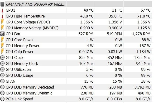

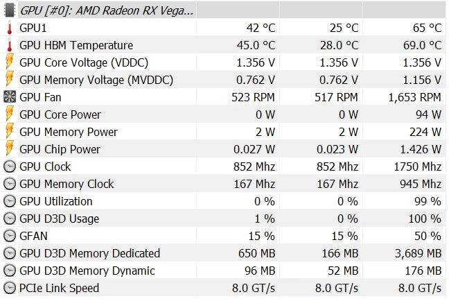

Here's some quick HWINFO64 stats while it's uploading.
Stock settings (1750Mhz/945Mhz) +50% PL
Undervolted -0.075mv (1750Mhz/945Mhz) +50% PL
The 0.075mv undervolt allows for about a 10% reduction in required fan speed to maintain 65C. 30-35% fan speed is required and that is silent for me.
