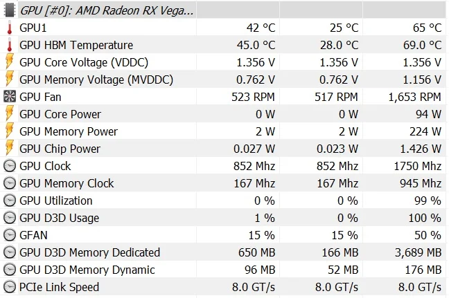

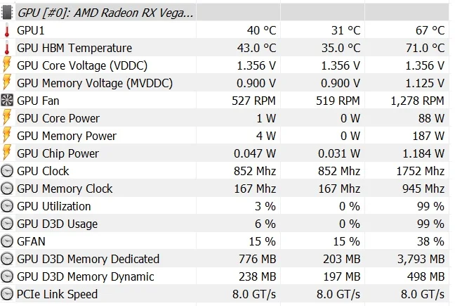

Here's some quick HWINFO64 stats while it's uploading.
Stock settings (1750Mhz/945Mhz) +50% PL
Undervolted -0.075mv (1750Mhz/945Mhz) +50% PL
The 0.075mv undervolt allows for about a 10% reduction in required fan speed to maintain 65C. 30-35% fan speed is required and that is silent for me.
{snip}
Thanks - I presume that with the undervolt you've also been able to see higher frequencies maintained (and showing up as better performance in the game) too?
Not really, if you max out power limit maximum frequency state will be maintained regardless of available voltage used in Wattman.
Matt I take it the vddc voltage reported in hwinfo doesn't talk to the i2c register yet,
as both screenshots show 1.356v
Yes i mentioned this in my video, however my logitech headset decided to mute itself so no sound came out, Lol. It reads that value whatever change you make to the voltage.
I have internal tools which measure voltage, it is 1.2V at stock and 1.125v when undervolted, with minor fluctuations.
brilliant thanks for the info, as just wanted to know what stock voltage is,
