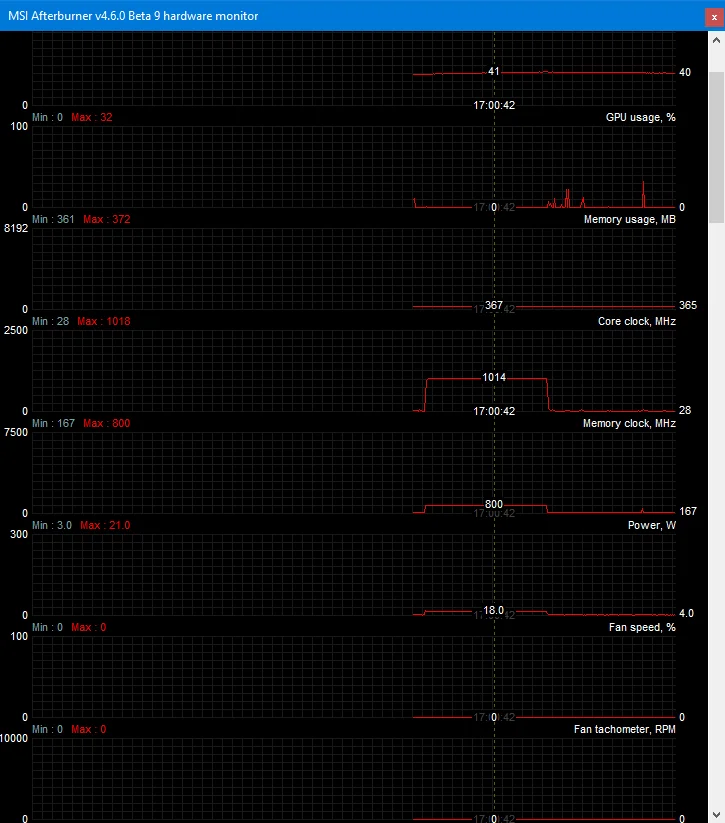

Tried those, still high clocks on lock screen. I also tried a clean install of win 10 on a spare SSD - same issue. I guess its specific to my hardware? I'm surprised no one else can replicate it
Tried to replicate it with both card and failed :(
You said you going to install MSI AB and have GPUZ off, have you done so?
Just by any chance, you haven't activated the min/max speeds on the default profile yes?
If so the card will be running at max clocks even on desktop.
Same issue with afterburner installed, the high clocks are while its on the lock screen then it drops to normal as soon as I log back in. Also its both the GPU and HBM clocks that are high, not just HBM.
