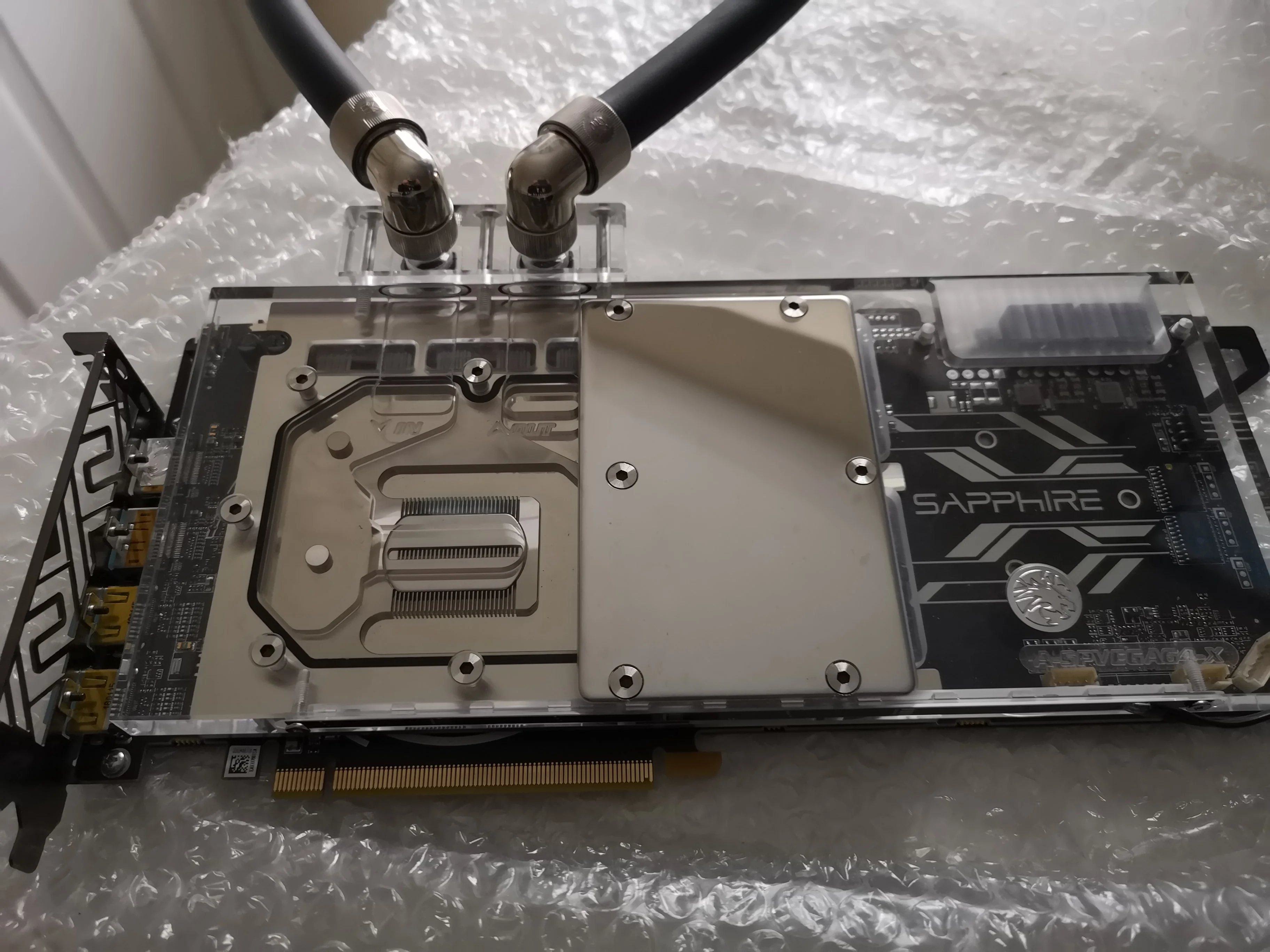

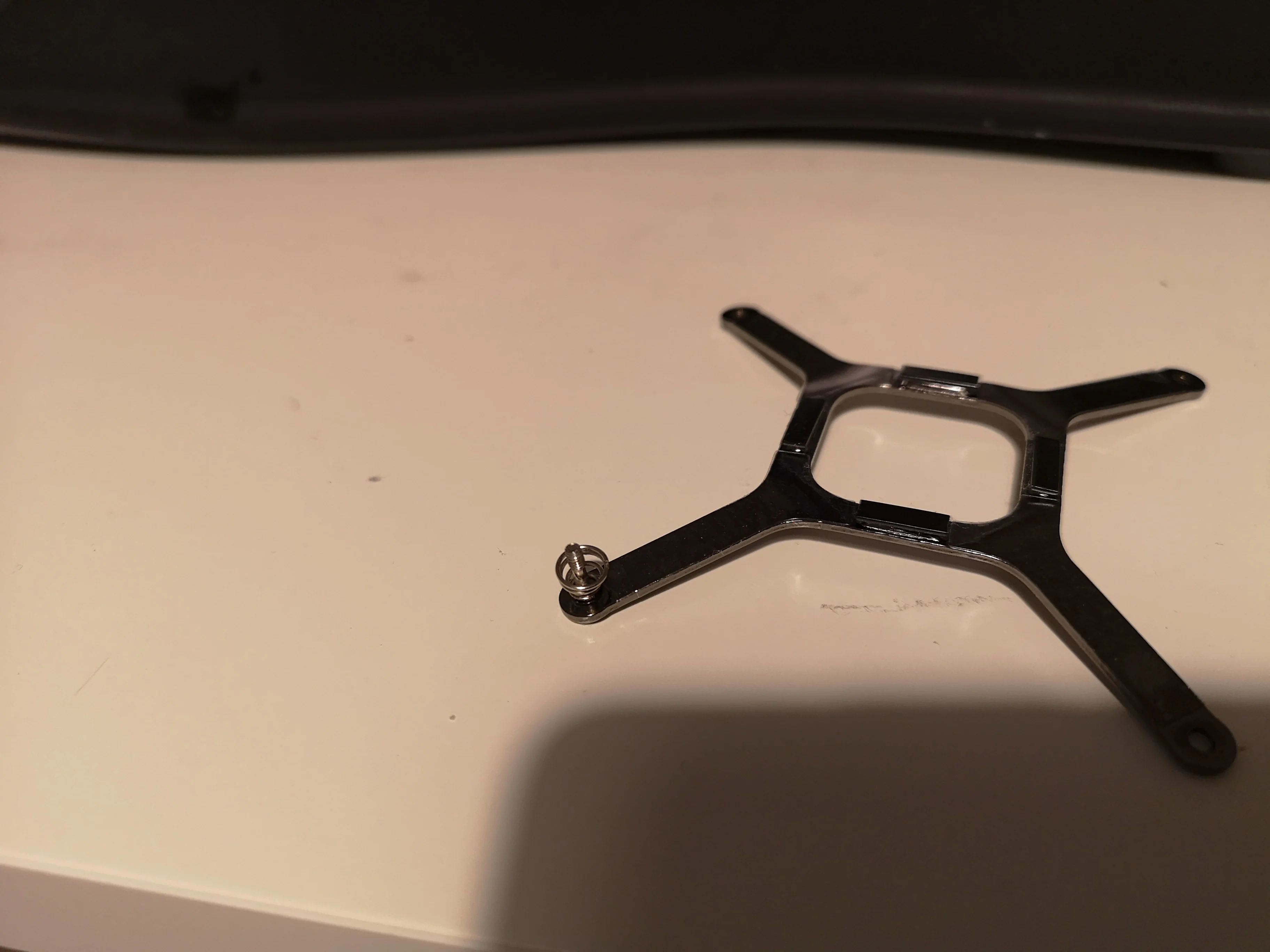

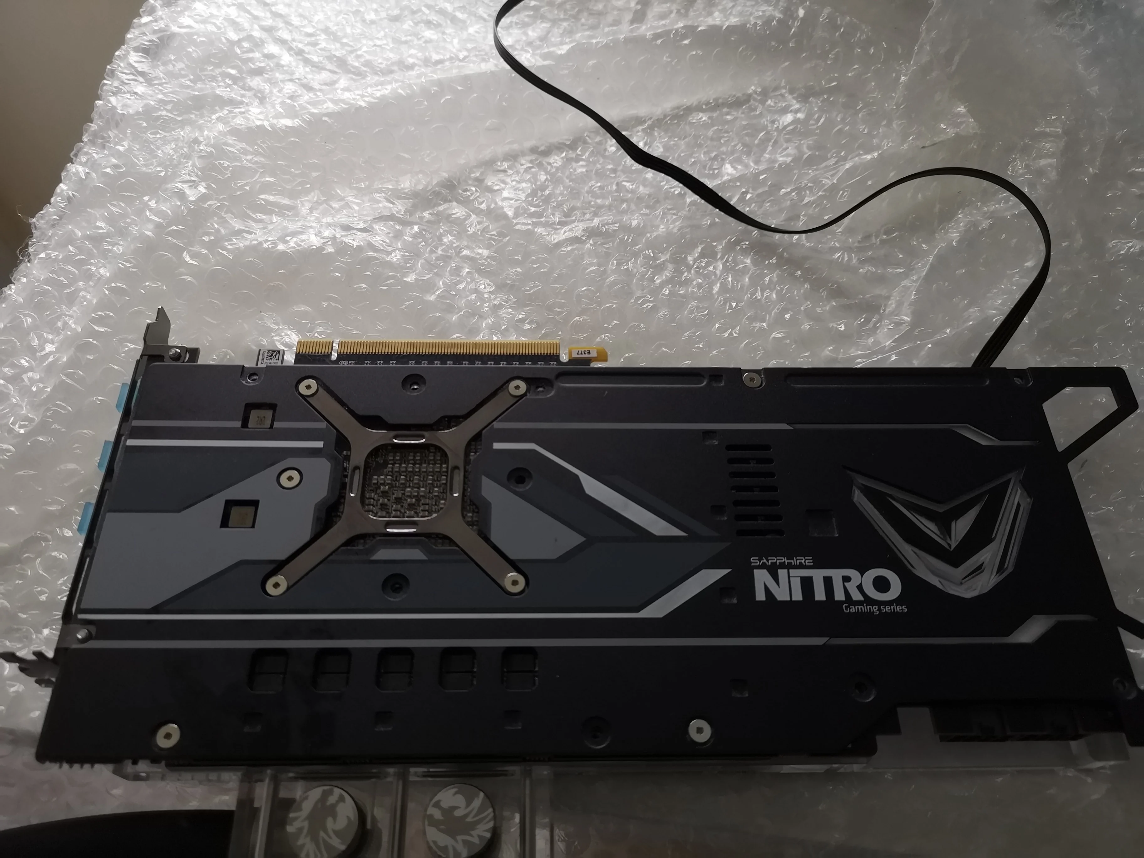

Here they are
As you see used the long ones with the springs and retention bracket, contrary to the manual, because I used liquid metal. If you use normal thermal paste not needed.
Ah thanks, that looks awesome!
Will keep it in mind for future :)
Apologies there must have been some confusion from my posts. I don’t currently own the block as my whole rig is on air I just wasn’t sure which blocks would fit the Nitro+
The Bykski is the one and confirmed is copper. :)
