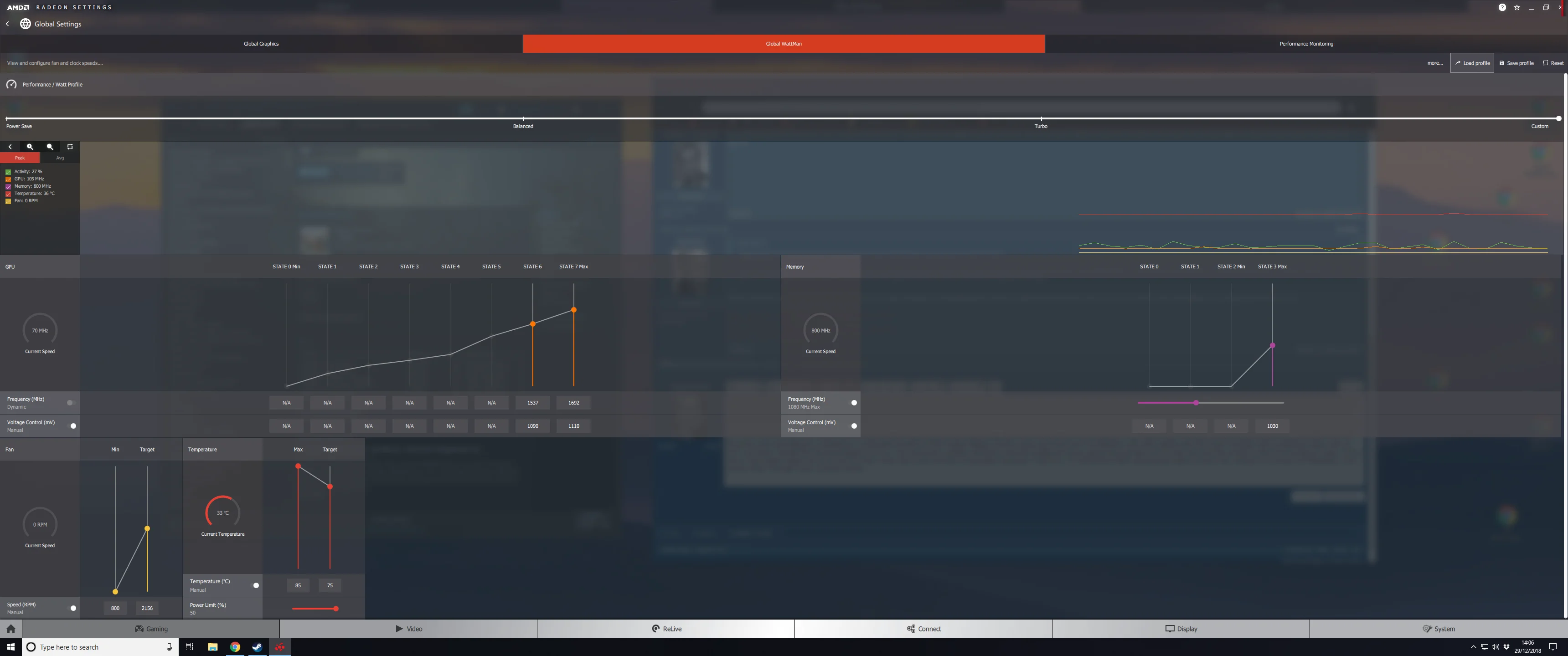

Are you sure the memory is stable, also the cpu?Having a few probs with Firestrike extreme crashing , potentially on stock settings.
Ryzen 2700x , mem 3200 xmp at cl16, asrock taichi x470, Vega 64 LC now with EK block. Superflower 1kw PSU, Vega power connectors on separate rails.
Pbo is on and a voltage offset of -0.06250, otherwise nothing else changed.
Temps are good, hotspot is good etc and games etc seem stable. Thought i'd start with undervolting the Vega.
Timespy and gaming seemed fine.
But Firestrike Extreme keeps crashing on the Physics test. So put everything back to standard vega profile, but still lots of crashes.
Perhaps its not Vega settings as its probably CPU / Mem on the physics tests .. but see further below ...? . I've had no issues with gaming , BFV etc very stable once 1st patches out. Moved back from 18.12.3 to 18.12.2 but still same.
Relive disabled, free sync disabled, chill disabled.
Heres the odd bit
Timespy / Timespy extreme fine on Balanced and various undervolt settings. I did get an occasional issue so intended to start again with the UV and keep HBM at stock whilst slowly found stable settings. Played BFV for a few hours without issue ( i know its not the best stability test )
Tried Firestrike extreme , crashed on undervolt on physics test.
So put Vega back to balanced. Still crashed.
Put to power save , worked fine.
Put back to balanced after power save , worked fine.
Put to turbo, worked fine.
Restarted, put back to balanced, crashed.
Put to custom, kept stock settings bar Power Supply at either 25% or 50%, worked fine.
Any ideas, or am i barking up the wrong tree ?
Have you tried a complete driver clean with DDU ?
What bios is the gpu using?
Did you change anything else recently?
Not really changed much, its kind of a new system, Ryzen etc from early December, Vega have owned for a while, PSU a while.
No not sure if its stable, but odd that if its the CPU / Mem, why does higher power on the GPU stop the crash. Whats my best bet for eeking out any CPU / Mem instability . Mem Test for mem ? Anything that will hammer both together ?
Bios, its a standard Vega LC , Sapphire, are there bios updates for the LC ?

You could start by using ryzen master and checking it in there by turning on the mem and cpu check options then running a test, and also mem test yes , thats my go to, (the one you have to run multiple instances of in windows)Not really changed much, its kind of a new system, Ryzen etc from early December, Vega have owned for a while, PSU a while.
Cheers
Heres the odd bit
Have you tried increasing your cpu offset vcore to around stock or so, whilst experimenting with the same gpu profiles. Does the system crash in exactly the same part of the physics test, everytime?
AIDA 64 will also do these things.
Yes there is also more recent versions of the LC bios that might help you, depends which version yours is (gpu-z will show you) then pop to techpowerup for a list of the vega bios's and use DDU and atiflash to achieve the update of bios.
If you set you Vega to +50% power , 1000mv for the HBM, and p6 1080 and p7 1100 does it still do this crashing?
Physics test on Firestrike crashing is the CPU 99.9999% of the time. The GPU does practically nothing for this test.
