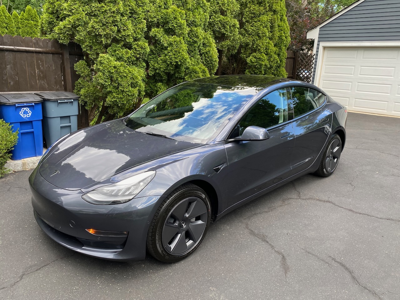

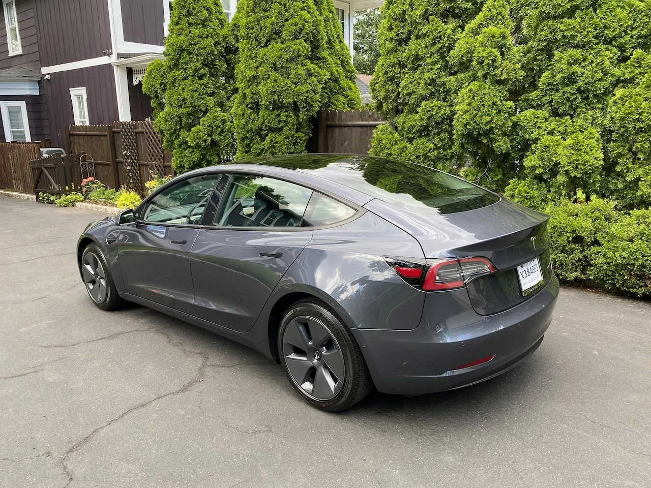

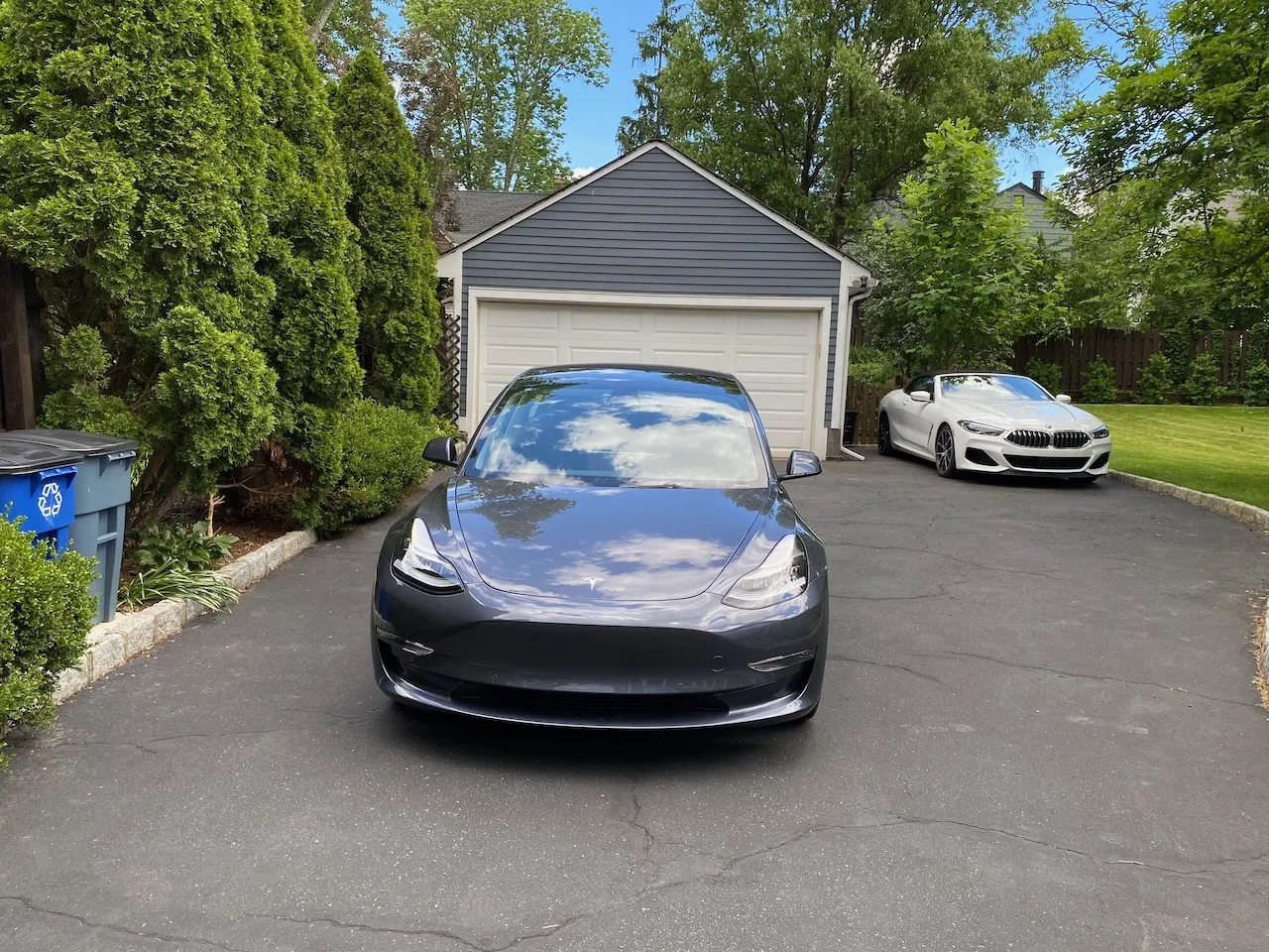

My Model 3 changed color a few weeks ago ;)
