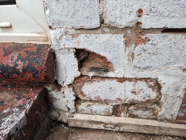

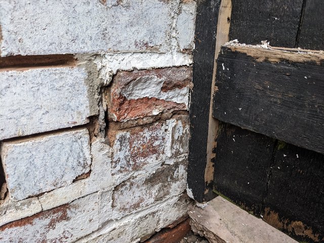

Things have taken a turn. The brickwork is far worse than I realised. Gonna have to get that corner rebuilt from below ground level up at least 5/6 courses, and a few feet in either direction out from the corner.

Im still not convinced though. If I can get my hand under a whole brick (and I have no idea how far back or deep that void goes) then I'm concerned it still would be better to get new engineering bricks put into the corner. I'll see what estimate the builders I have contacted come back with.

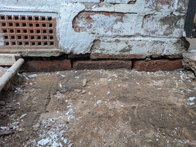

Your air bricks are curious, they have been replaced I'd say (older ones are a brick size usually). More importantly, have you located the DPC - this should be 150mm above ground level...one of my places this is exactly what had been done and the air bricks on the floor had let years of water in = the whole kitchen floor was destroyed including joists etc. so I had to rip it all out. Worse the clowns had been in there because I found a piece of wickes timber propped agaisnt a joist (they hadn't even bothered screwing it to the joist!).

This corner brick has some face damage and is right below the dpc. There's some kind of foam mortar stuffed in the dpc joint.
This is the bottom course right at ground level which I'm worried is compromising the whole wall. It's been eroded by water which wasn't running away from the house. Also that airbrick has been replaced by the looks of it and is a poor job.

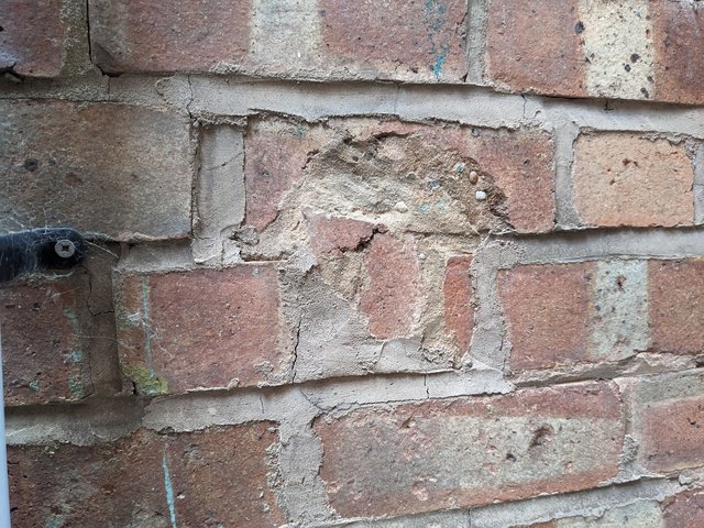

This brick has been hacked at to run an outside cable through.
These areas have been patched up where pipes have been through the wall previously.
And this is the bottom corner again you can see how eroded the bottom corner is.

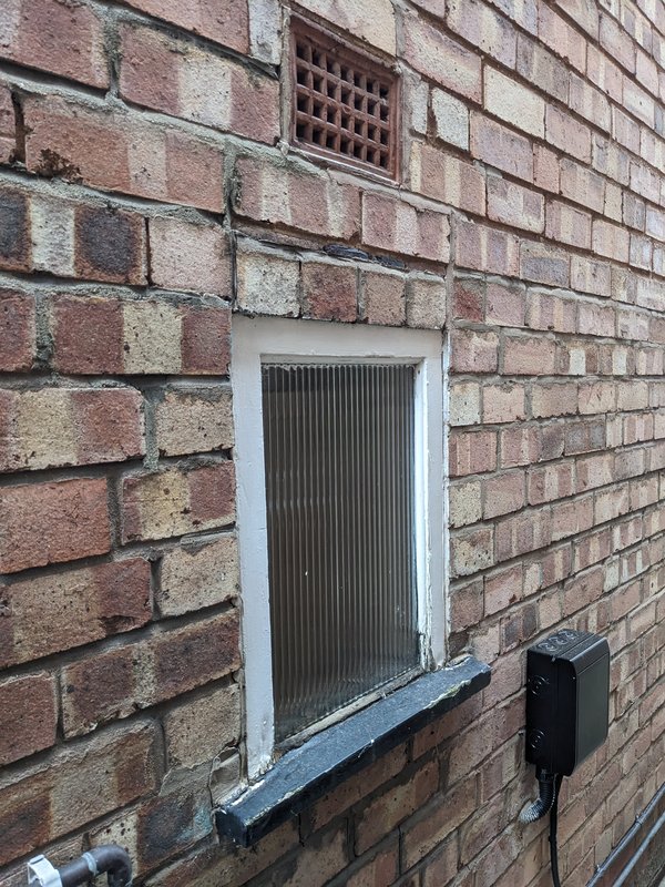

Plus I'm also having this old window bricked up.
Not a job I'm good enough to do myself.
