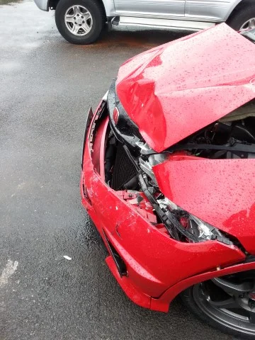

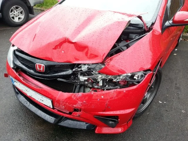

Think my interesting car days are over, been involved in multi car accident on m6 south this afternoon, quite heavy front end damage, some rear end as well, gutted is not the word :(
Oh dear... how severe are we talking damage wise? What happened and whose fault?
I only got one pic before my battery went flat which I took at the depot, will upload later.
Its my fault basically, everybody bunched up and a car (blue focus on the civinfo pic) slammed on the brakes to avoid hitting a coach that pulled out in front of him, I rear ended him.
Two cars made contact avoiding me I think and after the highways agency towed me to hw hard shoulder it got clipped at very low speed by somebody else (by this point rain was very bad indeed and there was loads of spray, and theres not a proper hard shoulder anyway, this being the managed motorway bit of the m6s before j9), this is before the flatbed truck could turn up to recover me.
The car is a probable write off I think, damage ia pretty extensive, weird thing was the guy in the focus was able to drive on without any real issue, where as my car has broken radiator, is leaking fuel and small bit of oil, gears wont select cos everything has been pushed back into the rods...

I checked my phone, got two pics of the front before the battery went flat on it. I think front end damage alone will make it a write off...?
