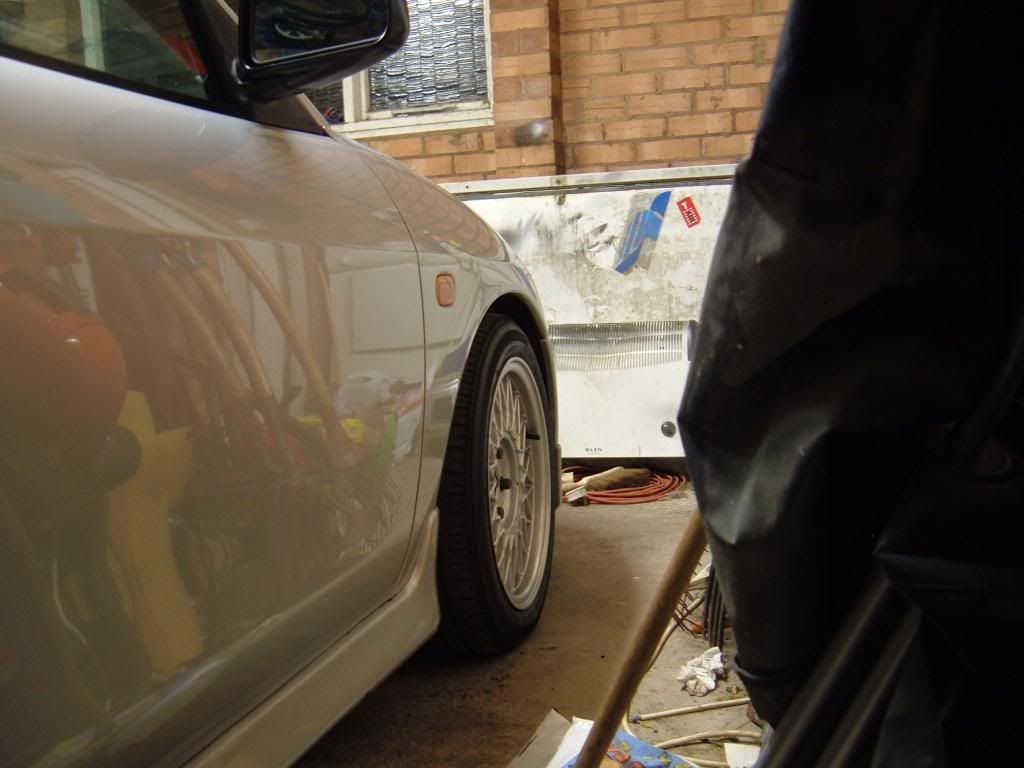

195 on a 5.5 would be pushing it a little I think. For reference, this is a 195/50 on a 7J wheel.
DSCF2062.jpg~original
How about 185/60? You can get Continental Premium Contacts in that size and a bit of Googling seems to suggest it won't be an issue.
