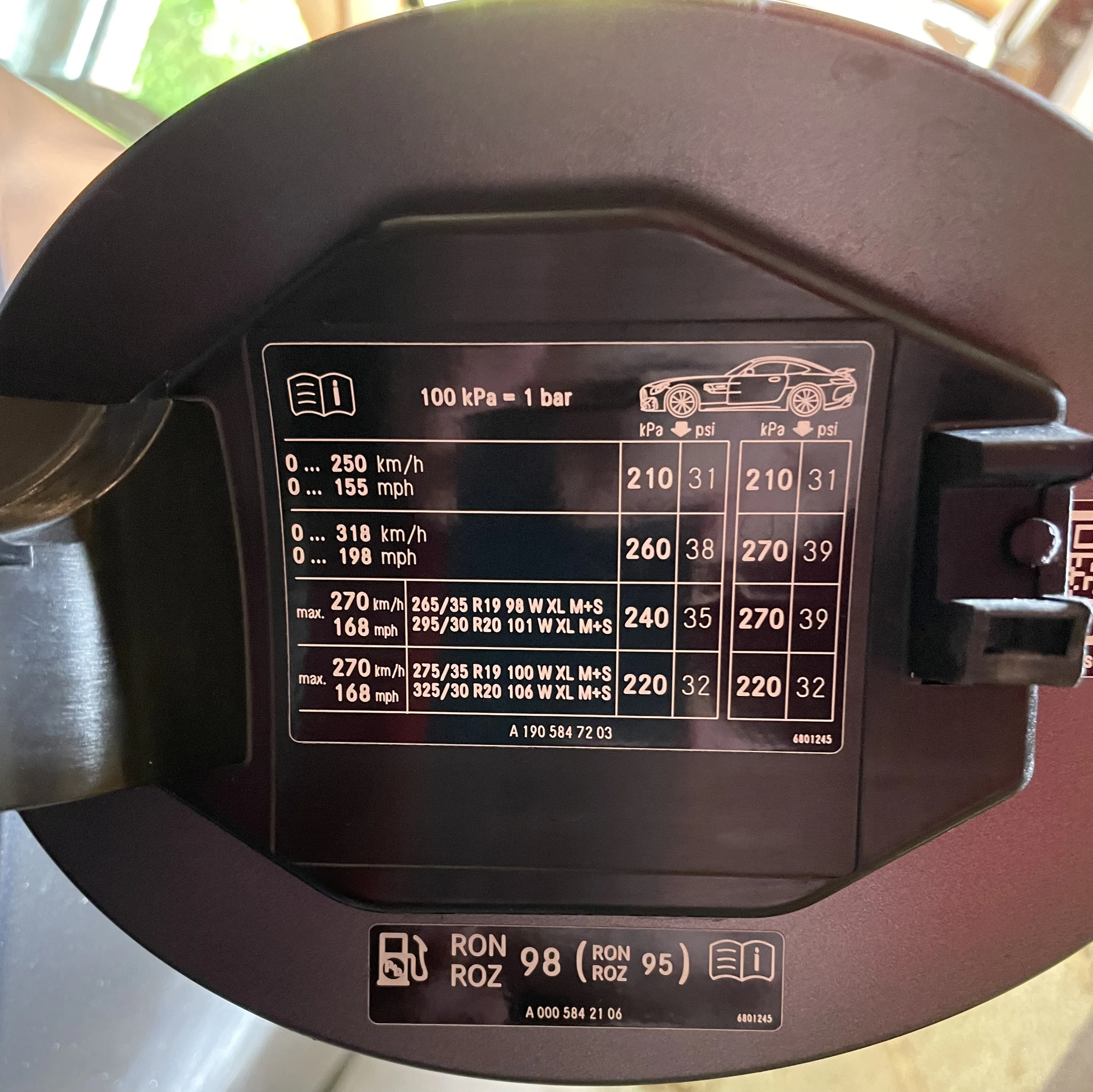

Another issue I am finding....load rating.
Current specification calls for 106, PS4S is 101
Thoughts?
Current reference point to add some details to this discussion.
Load rating is mainly about load at pressure. Hence you see higher pressures on lower load tyres. Personally I wouldn’t worry and compensate with a tweak high pressure within what’s on the fuel cap.
It’s not a heavy car and won’t have 3 passengers in the back. The different of. 101 and 106 is 125kg in simplistic terms. But obviously you are going to be leaning on it and not sure how this relates to dynamic load.
A 101 is rating to 825kg a tyre vs 950kg. But seems on smaller wheels you are ok at 101
I've stuck a post on a private FaceBook Group for owners I got invited to and MBWorld with this question. I have noticed that US centric places seem to be full of yanks who dive in to tell you what they have done, but rarely answer the questions you are asking, such as the one on loading or sensors. Will be an interesting experiment.
Mercedes and Michelin are also proving to be less than helpful on this matter.....which is annoying. Standard stock none answers seems to be what I have got so far. :(
