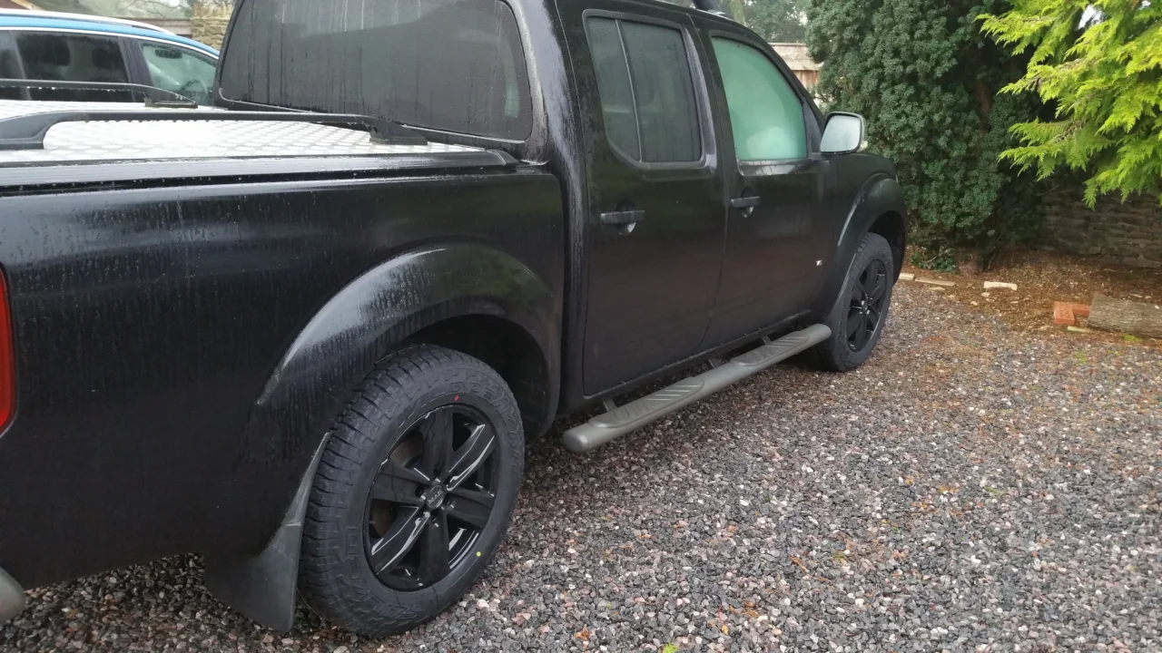

Not great pic as it is miserable this morning but just put my new wheels/tyres on:
Not too gone on the looks but didn't get them for looks.

Having done a bit of driving on the Falken Wildpeak AT3WAs now - seem well mannered on the road, a lot less road noise than the Bridgestone Turanza t005 I had on before - in fact surprisingly a lot less road noise than most of the 4x4 tyres I've experience of. Take a little more power to get moving from stationary and a little heavier manoeuvring at low speed but once up to speed don't really notice any difference to other tyres in that respect - slightly heavier but nothing major. Firmer ride than the Turanzas but eat up some of the bumps and undulations the Turanzas would become wallowy through. In the rain seemed to provide a similar experience to the Turanzas, feeling assured under acceleration and coming to a stop, though had more lateral play than the Turanza which tend to feel a bit "on a rail" like in the rain.
Only thing I don't like so much - the Turanzas have very smooth linear braking feel/response while the Wildpeaks were so-so initially when braking then bite hard making them a bit harder to taper off speed smoothly but that might change with more wear. Also scrub off speed faster than the Turanzas when you ease off the accelerator.
Haven't had enough time yet to see what impact they have on MPG - the average can take awhile to update sometimes and I couldn't really pay enough attention to the instantaneous MPG to compare but most of the time didn't seem any different.
Overall seem like a good pickup/4x4/larger SUV tyre though I'm yet to use them on anything other than paved and gravel roads/lanes to see how they perform when the going gets tougher. At higher speeds felt a bit vague at times so probably wouldn't want them on a performance vehicle (unsurprisingly).
In hindsight going with 255/65/R17 would probably be an improvement in both ride comfort and off-road potential than 255/60/R18 without compromising the connection to the road to any real degree.
