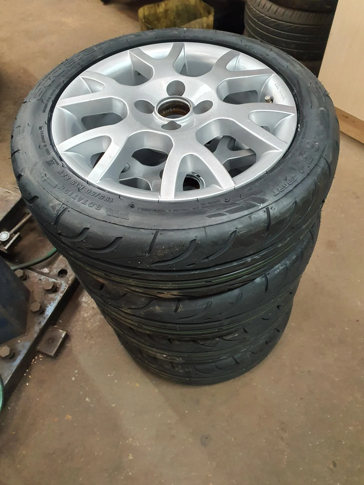

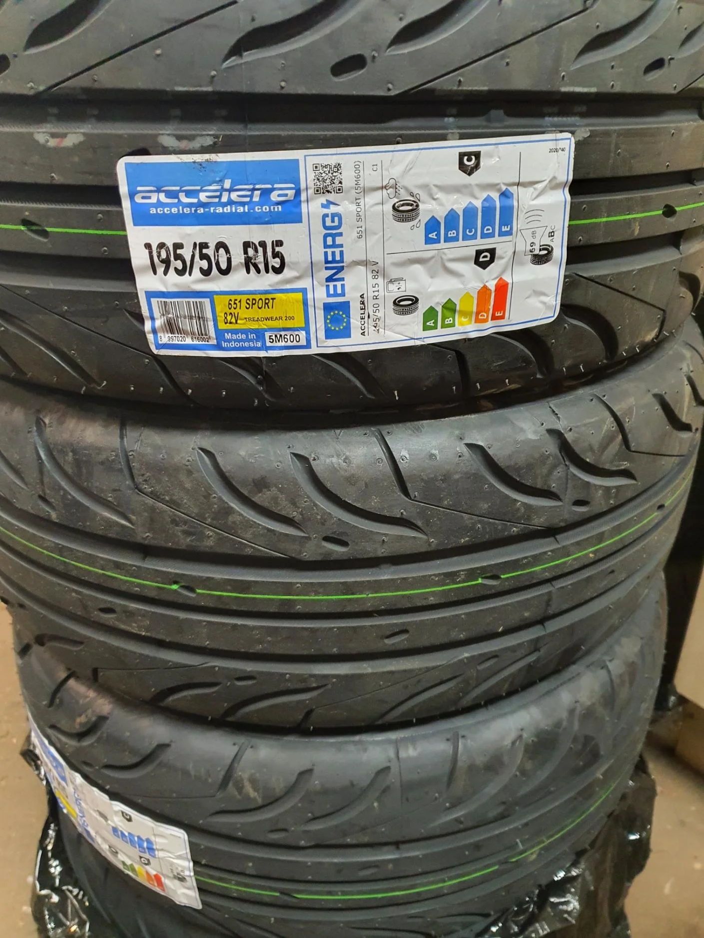

I can honestly say I never thought I would ever be buying Accelera tyres, but here I am with a set of 4 of them to try :D Not their usual road tyres though, these are their "street legal race tyre", and they happen to get pretty decent reviews. I think much like the likes of Nankang who make arguably poor road tyres, they do also make some pretty decent road legal "race" tyres. Coming in at a total of £275 delivered it's definitely worth a go.
Got them all fitted today.
I'll be fitting them to the car ('96 Astra with 2.0 Turbo) tomorrow night, but first impressions so far are good, the side walls are nice and stiff and the tread pattern looks pretty decent. A friend of mine just bought a set who recommended them to me has said so far he is really impressed with them.
Either way I should think they'll be better than the 7 year old Michelin PS3's coming off which had cracked and perished substantially from the car sitting around so much.

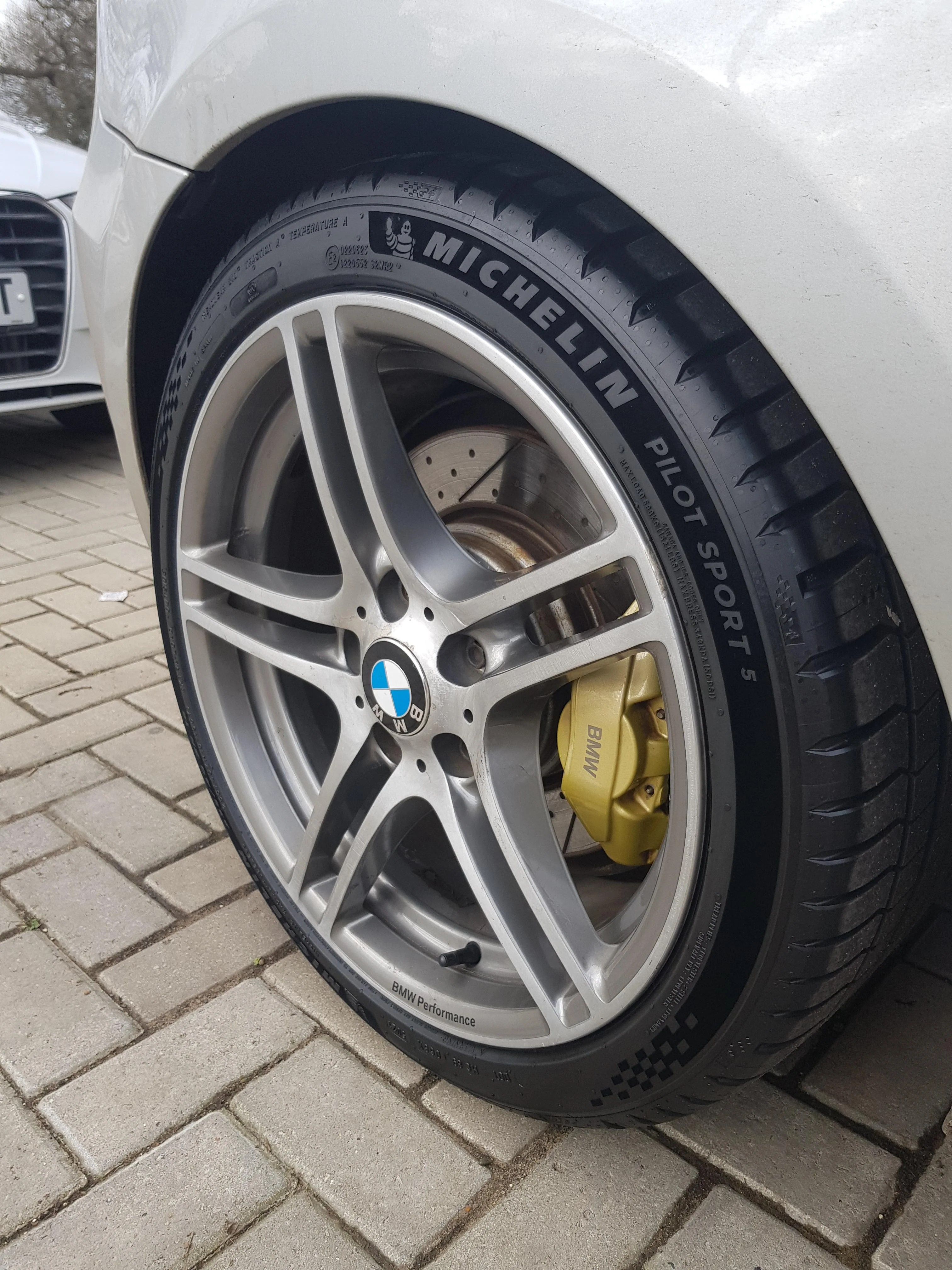

Also have a look at the Pilot Sport 5, the 4 is now end of life I would assume for most sizes as the 5 supports the bulk of common sizes and isn't dissimilar price wise.
The 5 is only available in quite limited sizes at present. It can often take a while for a new tyre to be widely available across a large range of sizes.
Yes true "end of life for most sizes" isn't exactly true, end of life for the most common sizes is more accurate. For example I'm not sure why you'd suggest a PS4 in 225/40/18 when the PS5 covers that size and is easily available (unlike the console) :o
Because I didn't know it was available in that size. Is just quickly looked at one tyre retailer and suggested some of the better tyres they had in stock.

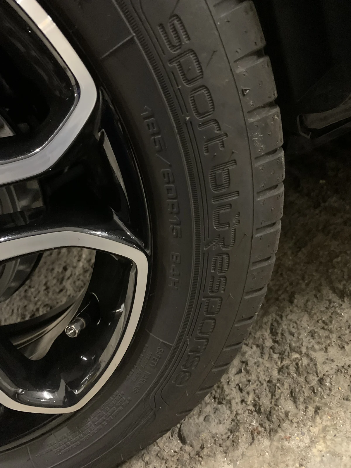

I've got Dunlop Sport BluResponse fitted to my Smart car from the factory. Do you guys rate them?
I've had BluResponse on my Focus (215/55R16 but equally poor range of options), and they are one of the better tyres available in smaller/"comfort" sizes imo, and probably the "sportiest" tyre (harder sidewall with less flex).
Michelin Primacy 4 is likely the only better option, with Goodyear EfficientGrip / EfficientGrip2 other recommended options.
