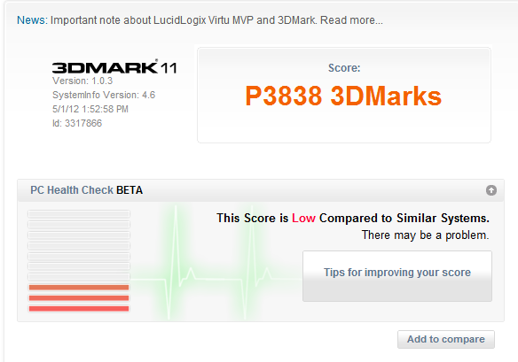

Hi guys,
I ran 3dmark11
Said my score is low compared to others, is it because most of the others seem to be overclocked?
Cheers
I think it is because of my card running at stock as I took a look and compared others and every one was overclocked... I do hope the pcie adapter I'm using wont affect performance any?
