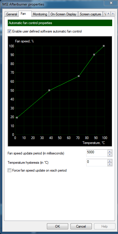

Loaded back up, temps were LOADS better. I created a proper fan profile in Afterburner which has helped a great deal to.
Before, I couldn't run Furmark for longer than 2 mins without the temps going to 90c. Now I just completed the full burn in test (15 mins), temps were still high but they didn't peak anymore than 86c. ) This was with 775/1125 OC To.
Running Tribes for a fair bit, 99% GPU Usage, 67/68c max.
Fan profile (You guys might think it looks dodgy, but it works well. Any tips for improvement on it though?)

So would you guys agree these temps are much safer to run at now?

Temps look fine now, forget about Furmark its a nasty test for any card, as above run Heaven or play your games for couple of hours to test your card/Oc.

Those temps now look perfectly safe - so now time to enjoy some games :)
