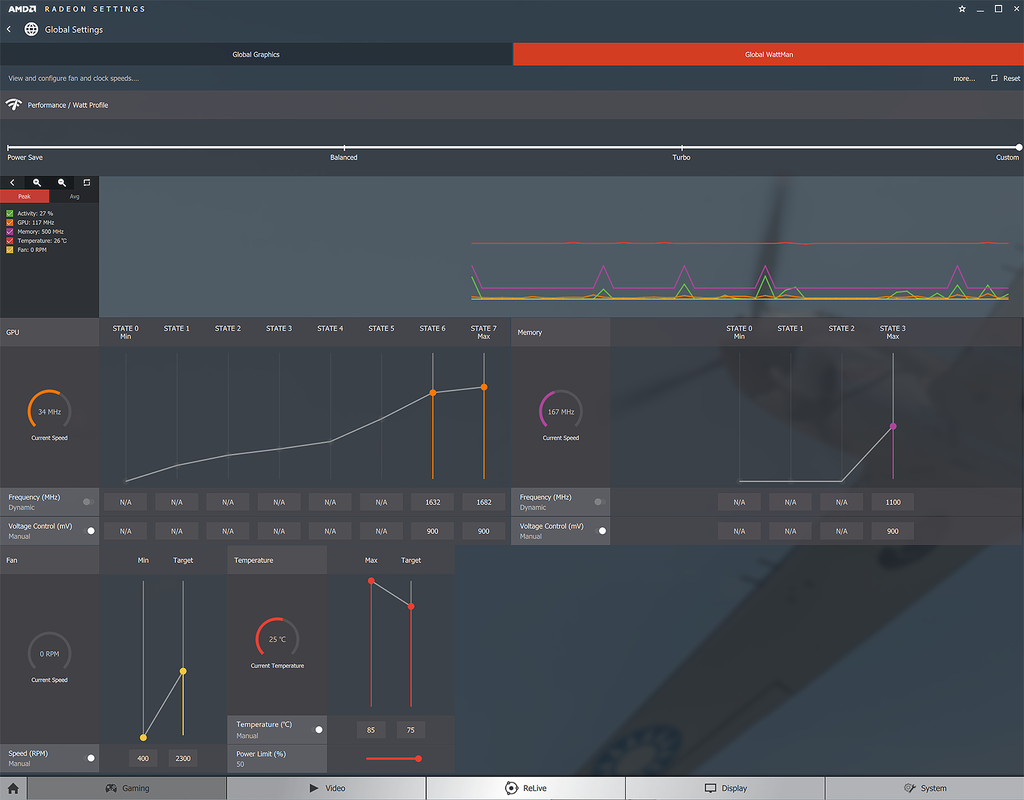

Overclocking Vega 64 in the classic way, where you set a clock speed is not the easiest way to overclock. Vega core clocks are now more to do with the voltage you provide/allow it to use. All my testing was done by setting the P6 State to 1632 and P7 to 1682, then leaving them there and undervolting to see the results. Setting higher P7 state would result in instability. Also ensure P6 and P7 states are different, or you may encounter a bug where HBM speed drops significantly.
Here is the table showing various clock speeds attained at the various voltage settings.
As can be seen, going from stock balanced to the max OC tested, results in ~15% extra performance. I only tested one game but it was fine as a reference point. I could push further by using registry hacks, or flashing the LC BIOS but I won't :)
What is astonishing is the difference in power usage from lowest stable voltage to max allowed voltage. 153 W to 325 W, over twice the power used for 11% extra performance.
As noted in the table, setting states P6 and P7 voltages to anything lower than the memory voltage setting had zero effect. So if you are undervolting, make sure memory voltage is set to your desired minimum voltage. This is why I believe many reviews got their undervolting tests to show voltages no lower than stock. They were just doing it wrong and assuming Wattman was broken.
For reference, here is the setting I was using on the stock cooled card. With stock cooler, max sustainable speeds with no throttling and acceptable fan noise was 900mV, 1435/1020, 2300RPM, core temperature was 77c - 80c depending upon ambient. This would result in performance ~2.5% - 5% higher than stock because it eliminates throttling. 150 W compared to 220 W power consumption, a 30% reduction in power consumption and still faster than stock.

"On stock reference Vega 64, drop mV to 900 for all voltage settings and set PL to 50%. You will get a better performing GPU that does not throttle, has a very noticeable reduction in power consumption, noise and thermals."

I gave mine a run out on 900mv on the voltage settings, 50% PL and it was great. I've been trying that new WH40K Inquisitor game which is a very rough alpha, in places the card would run flat out in menus, or certain areas setting the fan into over drive. After the tweaks everything was fine. Nice and quiet too.
