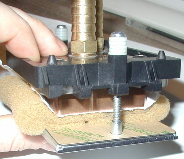

woohoo... i finaly got the guts to install my watercooling gear in my A64!
Id found a way of using an A64 hold down device for my Socket A waterblocks and it works great, i couldnt use my best block (ocpc atlantis) due to it being too high for the lengh screws i had, so instead i used a Maze2-1 i had lying around. Anyway:
quality use of boxes id say ;)
Note the hold down is upsidedown, and is used to push the waterblock down onto the cpu. It was rather hard to attach this way. Hope to get a real A64 block soon, or a better way of attaching a waterblock...
CPU temp 32c
Sys temp 32c
room temp 22
rather messy id say...infact, i might remove it right now... although its a lot better than my Barton setup i had before.

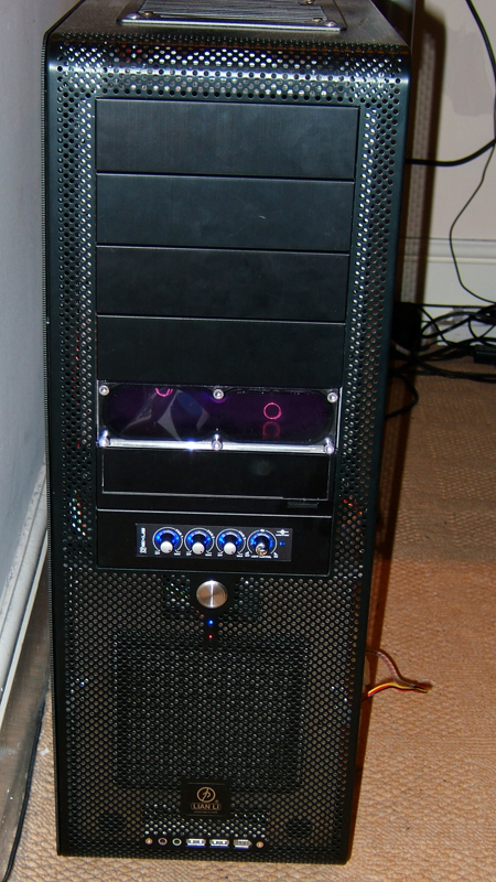

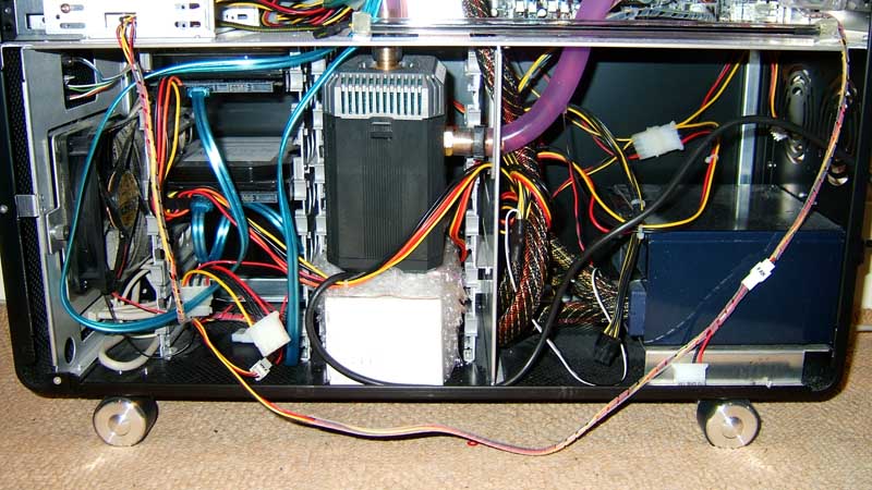

My Lian-Li pc-75.
Danger den waterblock, dangerden chipset block, dangerden GPU Block,
Thermochill 120.2 with custom sprayed fan shrouds. Using 1 Red Galaxy 120mm LED fan & Galaxy Blue 120mm Fan, with Heatkiller 120.2 Fan Grills
6" of dangerden clearlex tubing
2 X White, 2 X Blue, 2 X Red Coolmaster LED Fans
2 X UV Sunbeam Cathodes
1 X Blue Sunbeam Cathodes
1X Red Sunbeam Cathodes
Sunbeam UV Laser LED.
Matrix Oribital MX222 LCD Display
Coolermaster aerogate 2 fan controller.
Hope You Like!!!!!

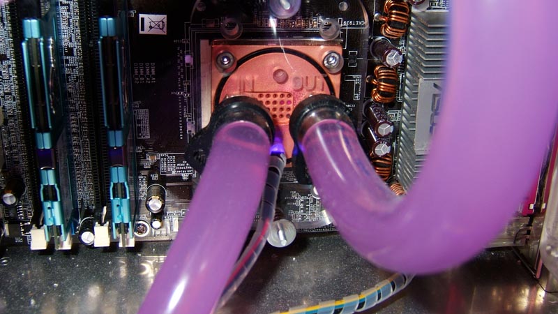

Just finished my WC setup.
Components are....
D-Tek LRWW Alu top.
Tygon tubing
DD Maze 4 GPU
Thermochill 120:1 Rad
Eheim 1250 pump.
Specs...
AMD XP2500-M - IQYHA 0351MPMW
NF7-S v2.0
1GB OCZ PC3200 EL
Radeon 9800Pro
Tagan 480w PSU
40gb samsumg HDD
Liteon DVD/CDRW
Piccies...
