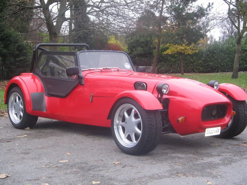

Heres a picture of my old car sold that this year for 5.5k
Right here we go then
94 SE live axle
1700 X Flow,twin 40 Dellortos
Megajolt ignition
5 speed gearbox
2.4 turn quick rack
Floor mounted pedal box with bias bar
R500 Caterham seats(grp copies)
RAC roll bar
Quick release Momo wheel
3000 miles from build with history and one previous owner.
Basically I got back what I paid for it two years ago although I did do lots of modifications to it myself.
The Megajolt,roll bar,seats,pedal box,steering wheel and so on.I probably spent more time modifying it than driving it but then I am a perfectionist with my cars.
Thats why I am building a Megabusa now so I can do it to my standards/spec rather than buying used and changing loads to get it how I want.
The new owner flew in from Belfast after only having seen pictures of the car and after 10 minutes of looking round the car gave me the cash there and then. Its back in the UK now as he is over here for the FOS at Goodwood.
