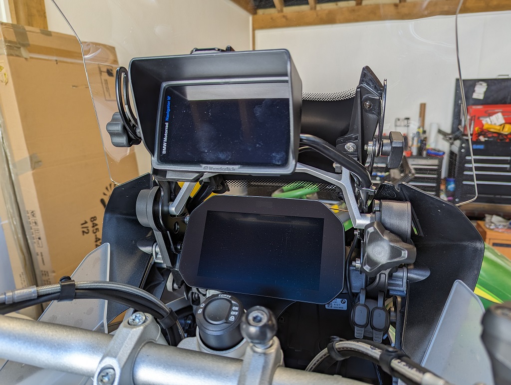

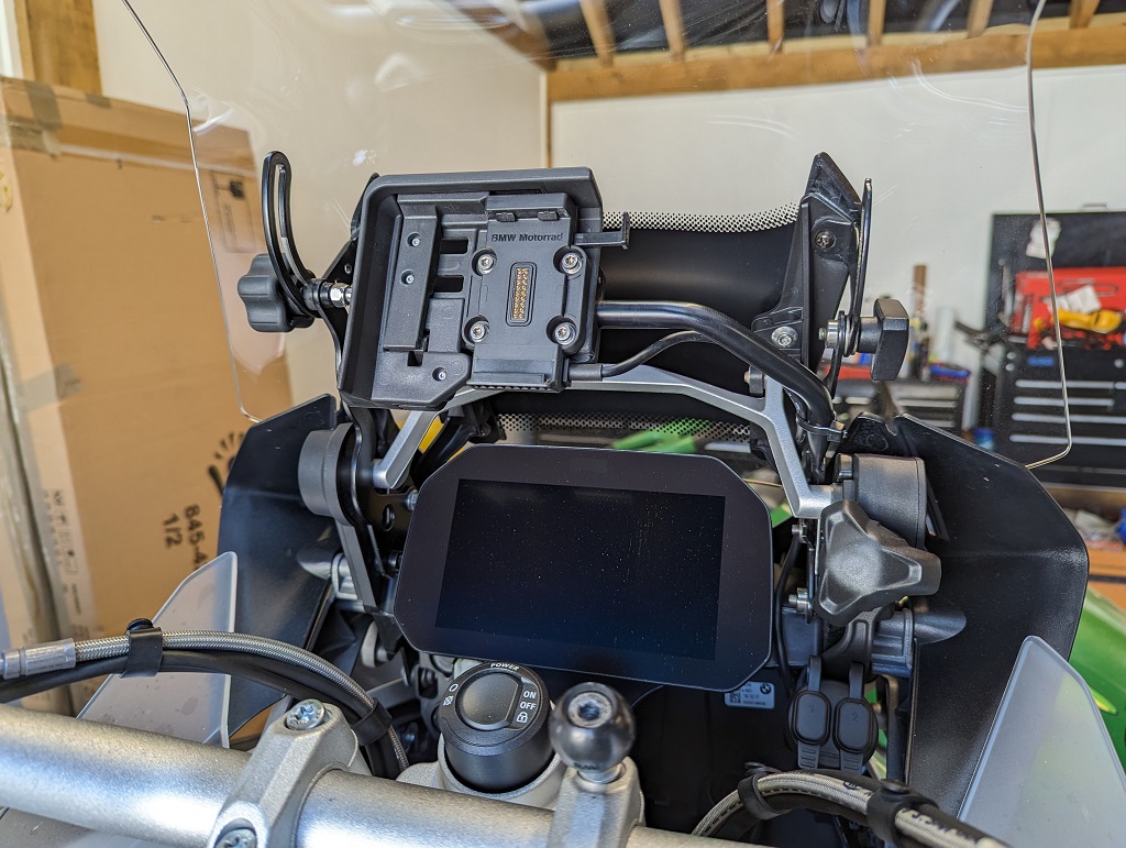

Ordered a typically overpriced BMW "Connected Ride Cradle" for my GS to replace the ageing Garmin Nav 6. Was delivered Wednesday, easy enough to install, remove old sat nav, clip in new cradle, job done!

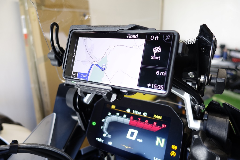

Install BMW's 'Connected' App on my Pixel 7 and pair the cradle via bluetooth, that wasn't so easy and took a fair few tries before it connected, removing/reinstalling app, reboot phone etc.

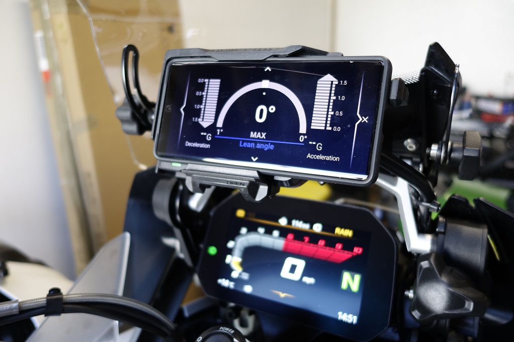

Once that faf was over it was a case of following on screen prompts from the app, controlling it via the rotary wheel on the left handlebar, works very well and some detailed info that's otherwise missing from ther TFT display on the bike.

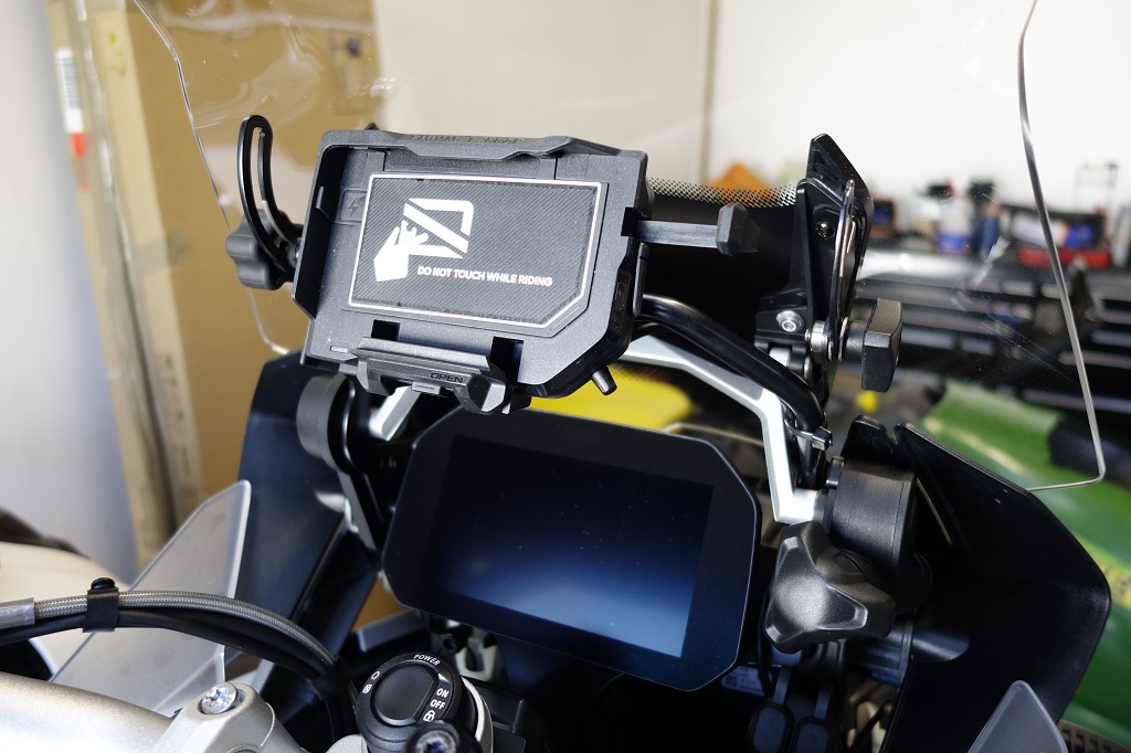

Only ridden it once with it during the night, but it works well and it has wireless charging, so no rogue cables (so it should for the price!!).
BMW's nav is ok, but the speed limits on my commute were all wrong, so when I need the maps I'll stick to Google Maps/Waze.
