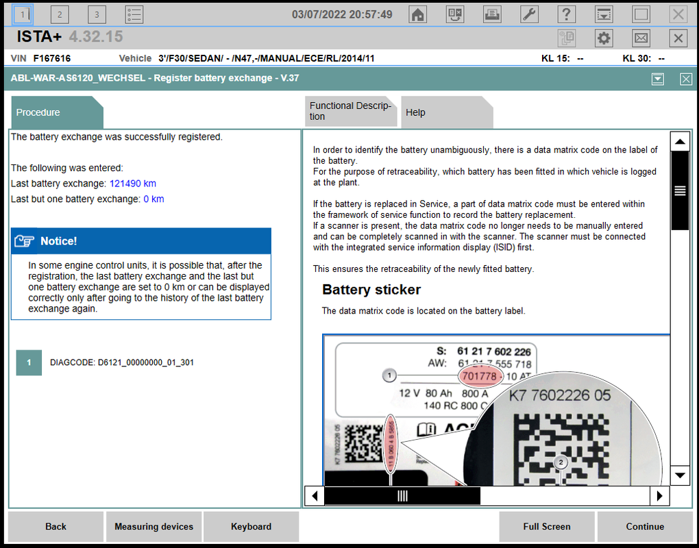

Still, at least I know it's been done correctly now:
It does ask if it's a legit BMW battery, and if it is then you are asked to put the data matrix code in - this part is as it says in the pic, for traceability. But it does also have the option to say it's a non-genuine battery and ISTA does go on about it being for charging according to battery ageing too.
So basically as I said it’s not really required beyond being able to trace when it was fitted, most likely for warranty purposes.
Well, it did say other stuff beyond what's in that image too, about it adjusting the charge profile for batteries as they age. I know it won't exactly be a safety risk if it was just left alone, but I just like knowing things are done right :)
The BMS will self adjust, registering will just initiate it immediately rather than taking a few days to figure it out itself.

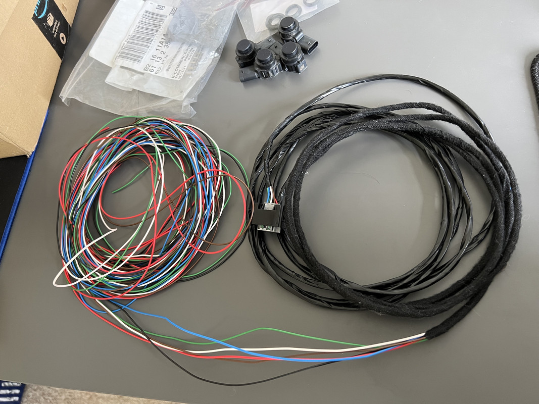

The only thing my replacement car is missing that my old one had is front parking sensors. It's not an essential, but definitely a nice to have so I'm retrofitting it. Luckily I have a set of genuine BMW sensors hanging around anyway so my only expense is bumper mounts for the sensors to clip in to and wiring.
The wiring harness for this is in two parts - the first being a cable that goes to each of the sensors with a connector that clips on to the bumper. The second is one that connects to said bumper harness and runs all the way down the car into the rear electronics module in the boot. First harness is only £37 direct from BMW so that's fine, but the second one is over £100. It's simply a 6 pin connector with 6 cables and 6 terminals crimped on the other end, that's it. Ended up buying 6 lengths of cable and the connector for under £20 and I have a few of the terminals for the other end spare already. Total cost for retrofitting front parking sensors in this instance is about £117 including the extra PDC button and paint for the sensors so not too bad.
When I finish wrapping it up it'll be pretty much exactly the same thing that BMW sell for 5 times the cost, just with different wire colours. Now just waiting on the other part of the harness and the mounts to arrive :)

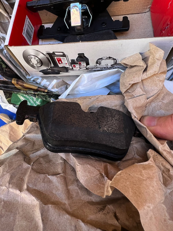

If it's looking that much better after only 2.5 miles then I'm sure it'll be fine in no time. The old pad in question was like this:
To be fair I did replace the caliper screw bushings and the pad retention clips too so it may not have been the pad's fault entirely, but regardless, I'm just glad to have some half decent pads on there now.
