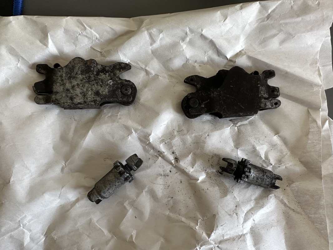

I thought I'd sorted out my squealing handbrake a while ago but apparently I hadn't. It still squealed quite a bit but annoyingly never when first setting off on a journey which makes it even more annoying to troubleshoot. When I last had it all apart I changed the rear discs, handbrake shoes and the springs for the shoes and the only things I left were the star adjuster screws and the expanders that the handbrake cable and lower part of the handbrake shoes sit in so I thought I might as well try replacing those before giving up.
I don't want to get my hopes up too much, but I'm pretty sure it's sorted now. One of the expanders is caked in more dirt than the other and also, there is a spring contact in each one. On one of the expanders, the spring offers resistance when I push it in as expected but on the problematic side, the spring offers no resistance at all and I can push the top part in and it just stays there. Pretty confident that's the issue and I've had no issues yet, but time will tell. I hate BMW mechanical handbrakes, next car will undoubtedly have an electric one.
