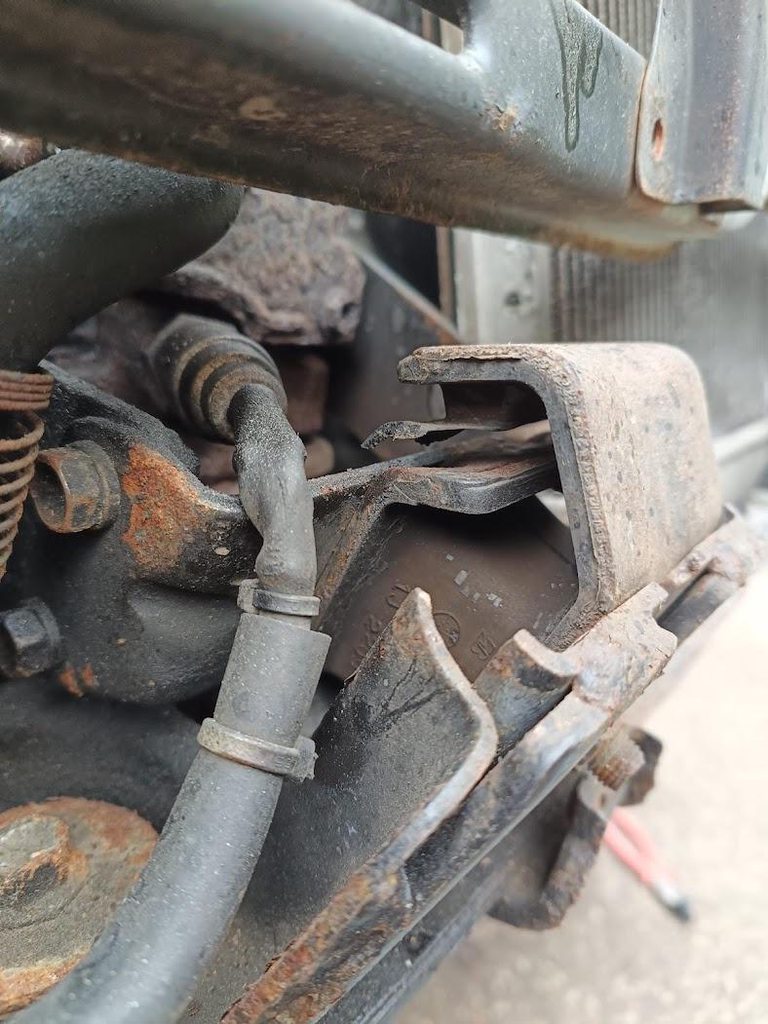

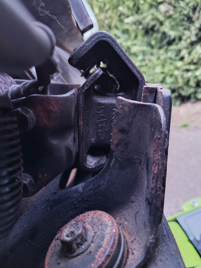

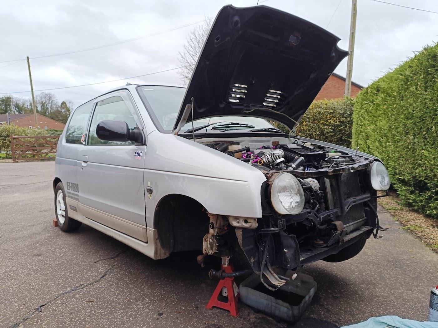

Put the new wheel bearing and driveshaft with new CV boots on, and though I may as well check the other side before I fill the gearbox oil... Now I'm doing the other wheel bearing, the other CV boots, the anti-roll-bar bushings, and the lower arms...

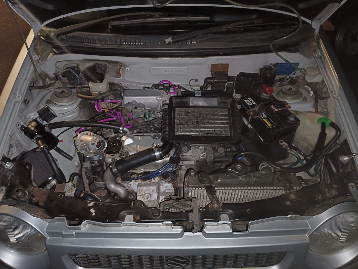

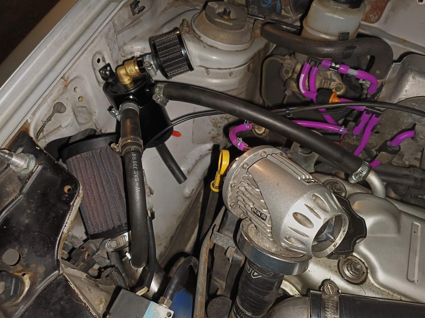

Fitted a catch can, and did the vacuum lines in pink mainly to annoy @grudas. New boost hoses also.

Waiting on parts to put the front back together, then need to adjust the rear suspension, redo the thermostat job because I ****** it up last time and it leaks, so I'm going to put a new gasket in, then it should be alright for a bit lol.
Chevrolet Matiz lower arms, MK5 Lancer diesel CV boots, Ignis roll bar bushes, and Daewoo Tico wheel bearing seals.
