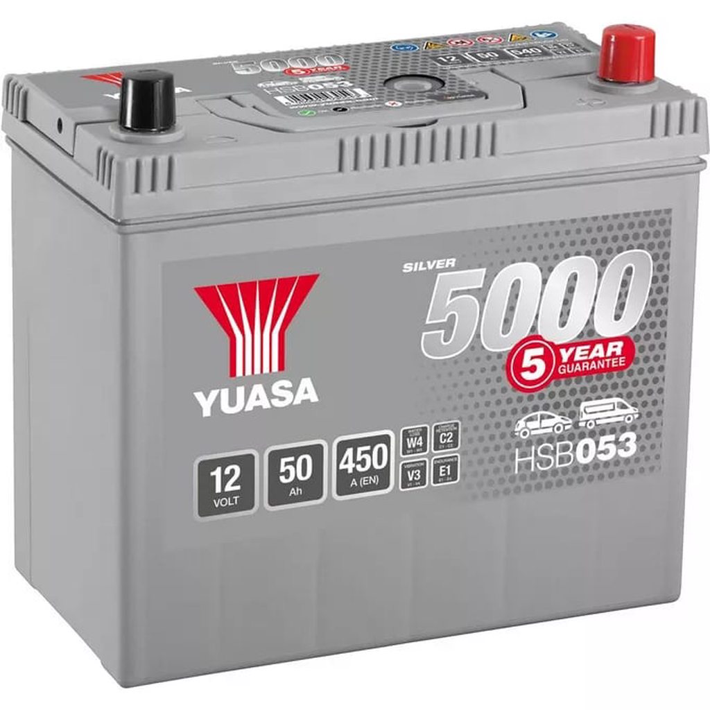

Took the Elise out for its first drive of the year, mainly bit of a test drive as its not been used in a couple of months. Battery doesn't seem to be holding much of a charge so put it on the conditioner but if no joy then I'll have to swap that out.

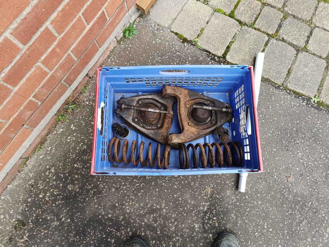

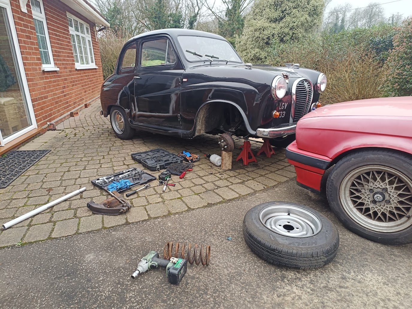

Set about replacing the wishbones on the Austin.
There is a proper order of operations to remove them, compressing the spring or removing the spring pan slowly with a jack under it to get the tension off, then removing the inner this and the outer that blah blah...
Nah mate, just undo the inner fulcrum pins and the kingpin top nut, hit it with a big hammer, and PING, Bobs your uncle... :p

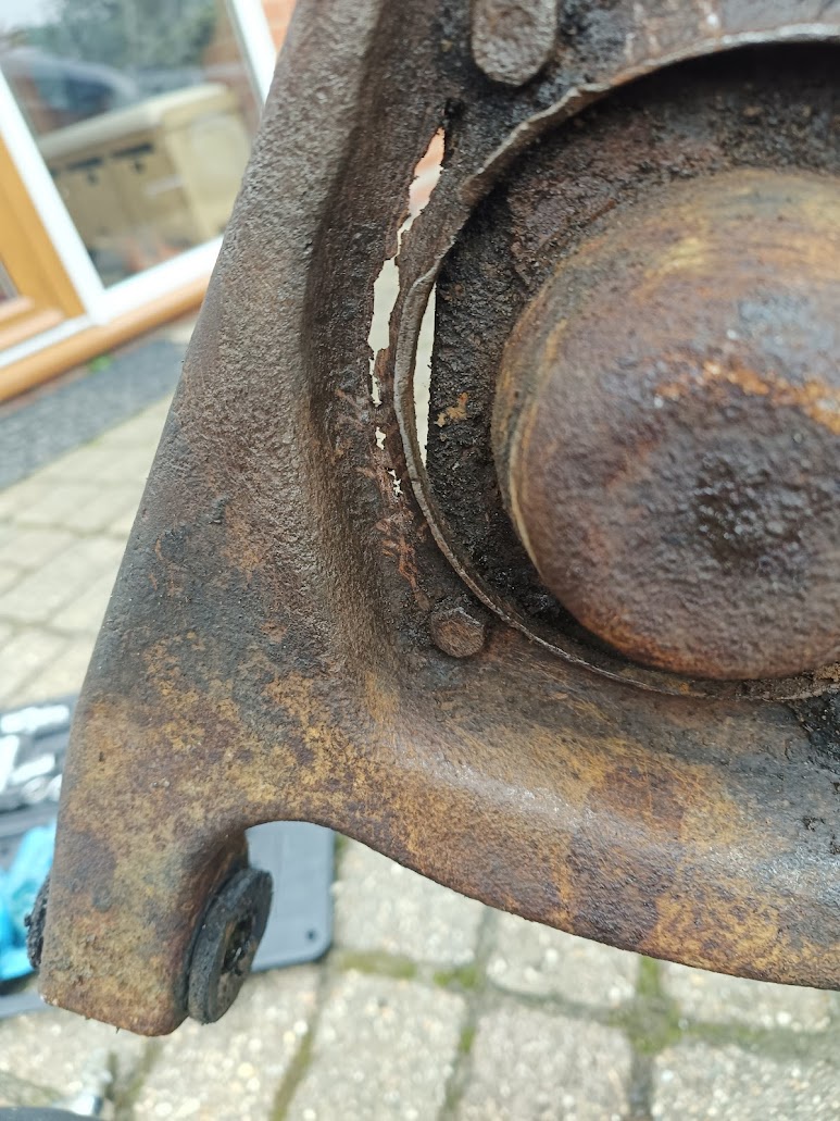

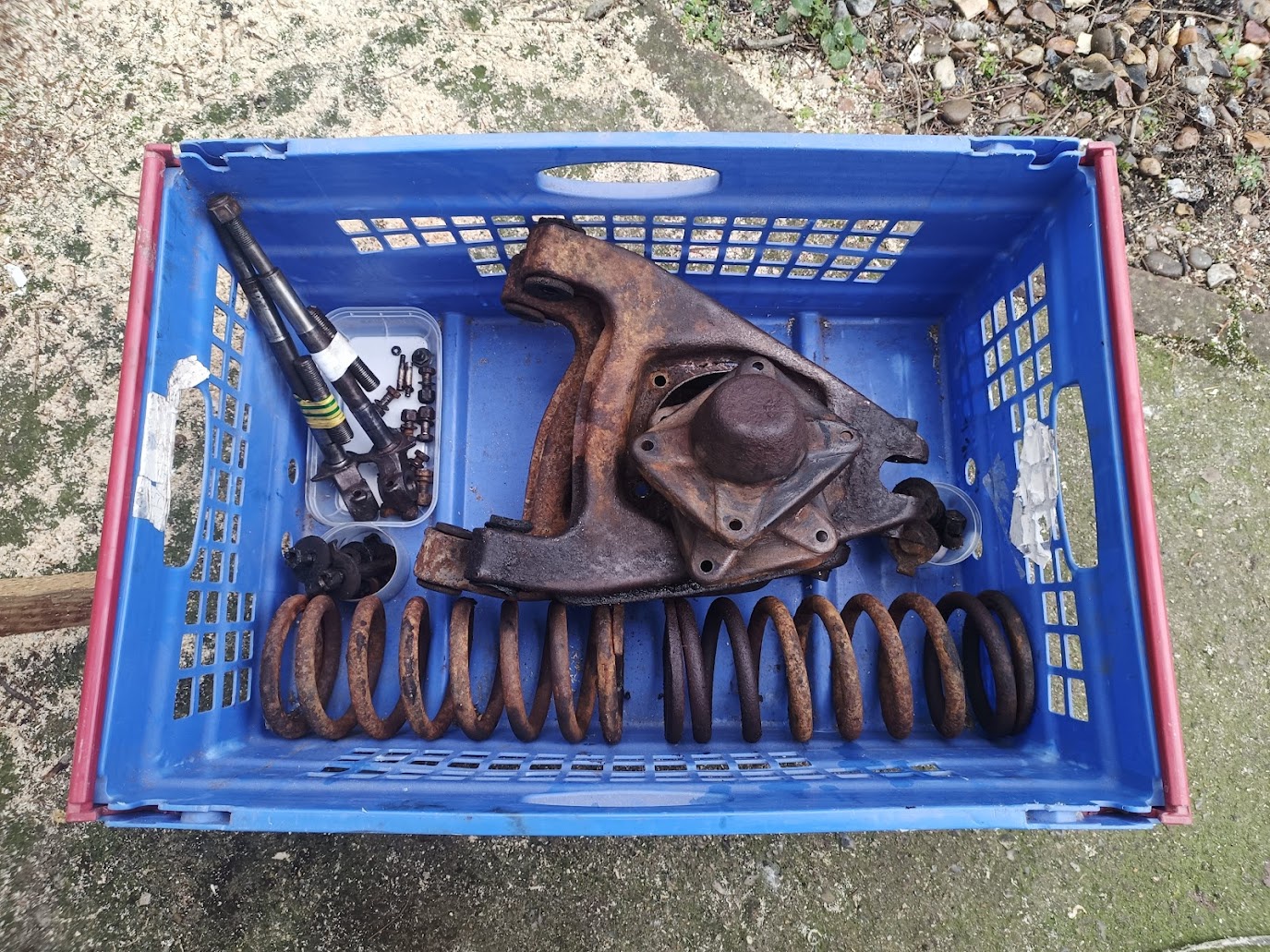

Reason for replacing...

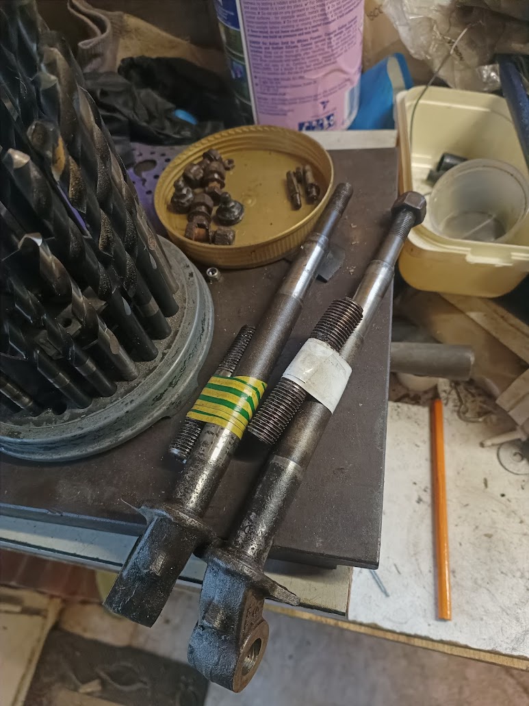

Kingpins came out easily, which was nice. Owners club said it would be a fight to get the threaded bushing out, but aside from the cotter pins/keys being a bit jammed in there, it all came apart nicely.
They are fairly pitted but they didn't have any play and they are approaching 70 years old so I think it can be forgiven, they'll go again.
Now onto prepping and painting the spring pans and the replacement wishbones, waiting on new bushes and ball joint dust covers, cork seals, fulcrum pins, cotter pins, etc.

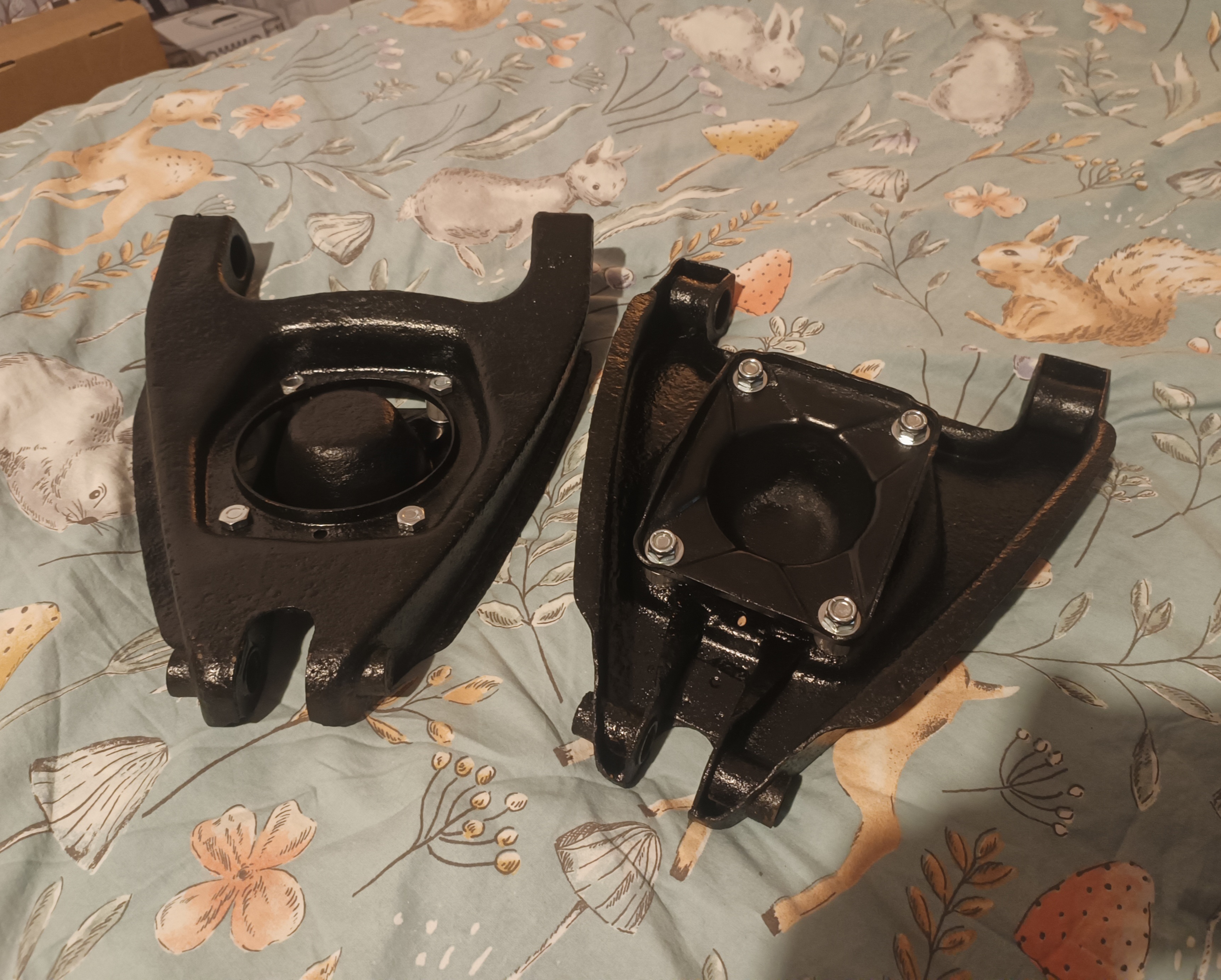

Replacement wishbones and spring pans painted, bolted together with new hardware and spacers between the wishbone and pan to lower the front end a bit.
Please don't worry about the nylock thread engagement, the nylon goes down a fair way into the nut and they're as tight as a *** **** in a *****! :)

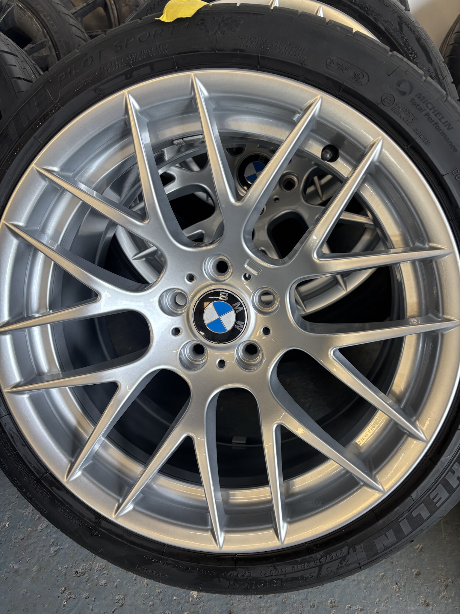

Refurbed M359 completion wheels for my E92 M3 Car in for remap waiting for Ecu back so garage will fit them for when it’s done Please as the previous refurb before I got the wheels was a mess and flaking off
New caps and badges on way
