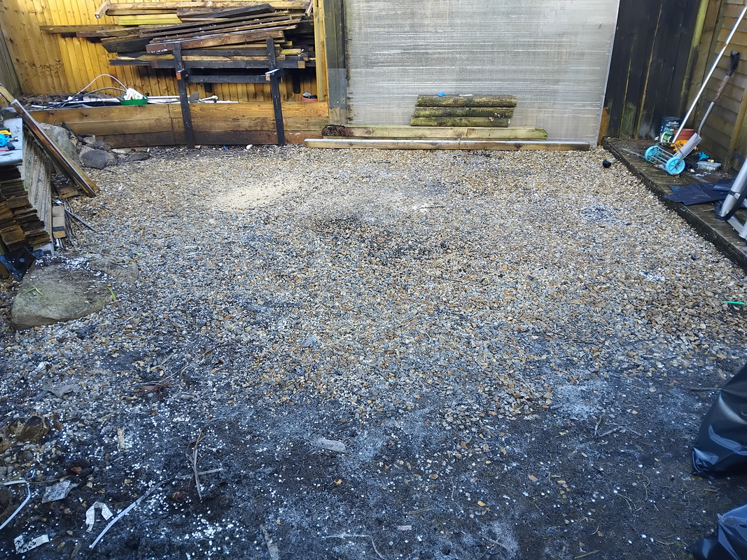

Space all cleared for the first half of the shed, greenhouse, solar roof build. Can fit the first 3.6 x 2.9 part of the build to fit the contents of the current shed, so i can then build the second half. The space was formally sued for this greenhouse i built in 2021
This previous post you made looks no where near ready for constructing a new shed. It is just a patch of dirt?
the 1mtr at the front is dirt - the 5mtr by 4mtr section for the shed is 2 tonne of yellow gravel and stone - there is zero mud in the area the shed will be on, ontop of that there will also be another 2 tonne of 14mm to dust to level the area and make it fully flat.

So you are going to build a shed on top of gravel then? :S

like 50 million sheds have been built on in the past...... it will be a base of 4x4 timbers, sat on blocks, with membrane under the timbers so water cant get wicked up from underneath.
why do you think that one picture is the finished area for the build, that picture was just showing that area has been cleared of the old greenhouse and old timber stacked away.
I was just clarifying because you said you had bought 36 timbers 2x4 like you were ready to get going; yet your foundation is gravel.

no issues with building on a gravel foundation dlockers, helps with draining water away from the surface of the timbers......dont have to have some elobrate base made out of screw rods, bolts and washers... its a shed, not a house or a home office

A proper insulated concrete pad is "best". Key word is insulated; not just concrete (or god forbid pea gravel :cry: :cry: :cry:).
@Buffman and I followed the Oakwood "rod" method. You lose height, which if that is a constraint for you may not be ideal (max height without planning is 2.5m from nearest adjacent land). The upside is it's clear of the dirt completely, and you can get it mm perfect by adjusting the nuts/sole plates.

If you want a "proper job" and have good access I'd do a concrete slab then a couple layers of engineering bricks and insulation.
If you have poor access I'd do the rod method @dlockers indicated.
10K Ish might be doable if you use cheap cladding /cheaper doors and windows etc.(upvc not aluminium)
