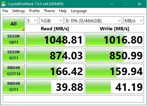

So my RSTECH RSH-329 enclosure turned up today and I've already tested it.
First and foremost, the USB connection is definitely more stable without any question. I can move the enclosure around, turn it, spin it on my desk and it doesn't connect a single time. In fact the transfer didn't even slow down, which might have indicated strain on the cable or connection. My Sabrent would have disconnected just picking it up, let alone anything else!
Secondly, the enclosure is also slightly faster in read speeds. Write speeds drop slightly, but not enough to stop me using this enclosure.
