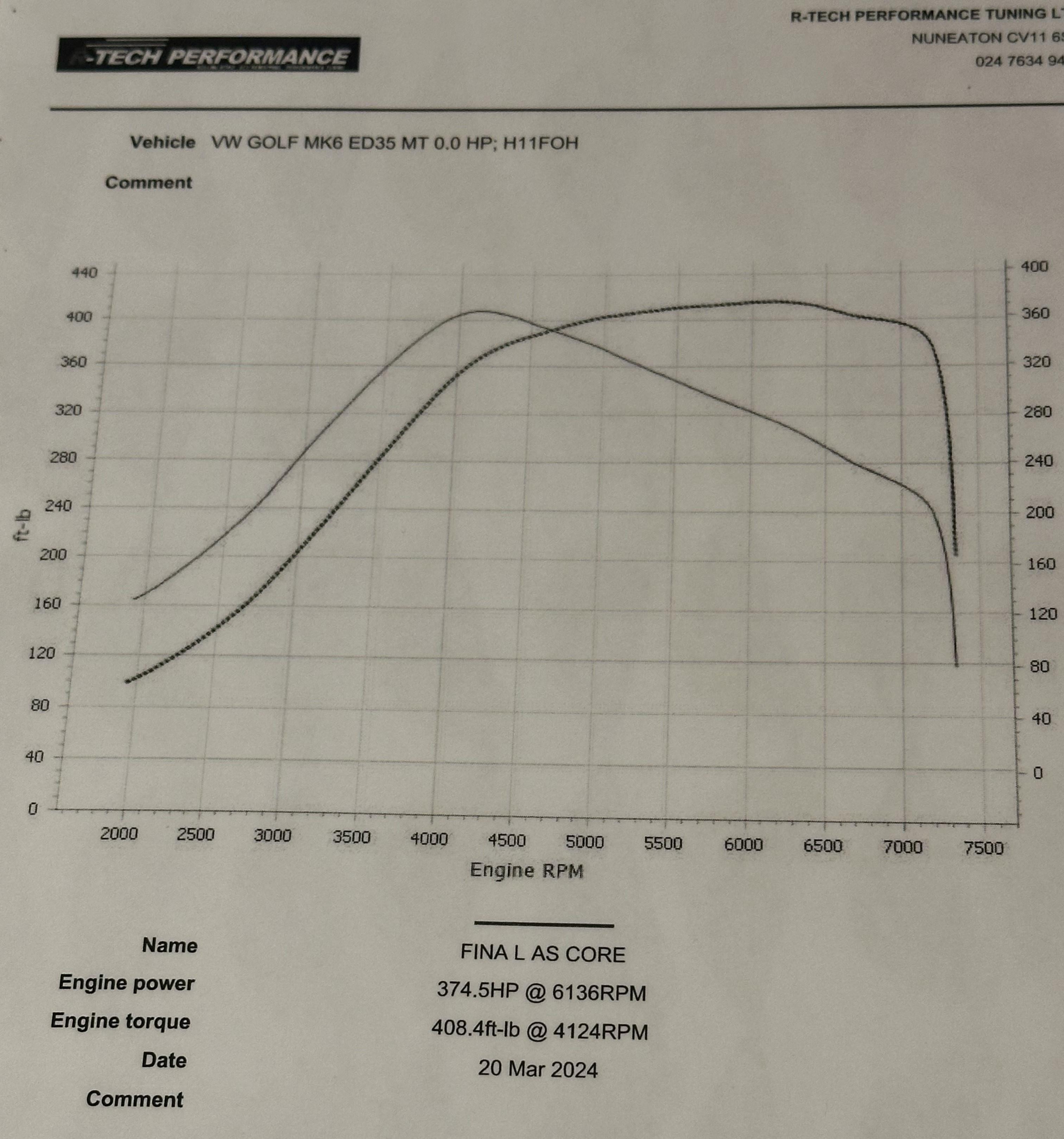

I was already 2+ but returned recently for a map revision with an anti-surge core and a stronger actuator, hoping to avoid the turbo surge lower down. I made +11hp but the diffference in volume of torque and at a lower RPM is crazy. No more DSG farts unless WOT is a welcome change, too.
Graph:
Please don't take your TFSI or TSI anywhere else.
