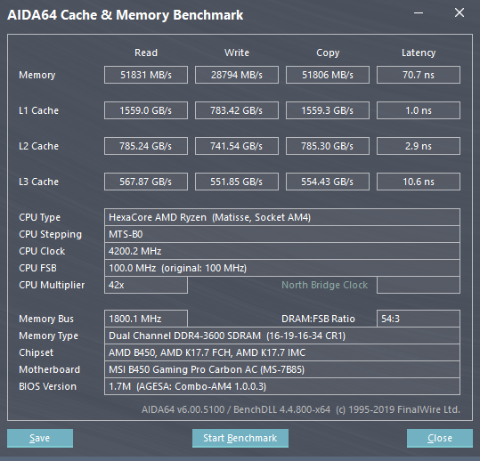

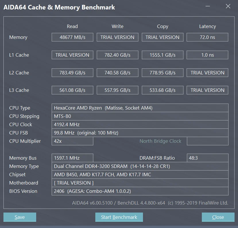

Can anyone run aida 64 memory latency bench and report the results.
3600, C16 with pretty slack sub-timings.
