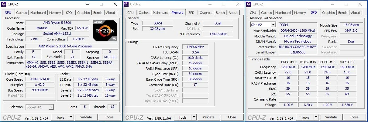

Getting in some further testing this morning, 64GB (4x 16GB) of mis-matched RAM works fine, using 2666MHz and 3000MHz RAM all over clocked to 3200MHz. Still messing with timings but it seems reasonably good so far, only C16.

Had a bit more time before this morning meetings to mess about with RAM, still not excellent, but getting there. @Plec

Anything in particular you had to do to get these speeds? My kit won't boot at 3400 MT/s or 3466 MT/s with "safe" timings at 1.35 V. In fact it just gets stuck trying to POST. No error codes but nothing happens for a solid 3 minutes. Have to forcefully power cycle it. :(
So far the best I can do is 3200 MT/s with DRAM Calculator "fast" timings with Geardown Mode enabled. Turning off geardown mode causes it to fail to POST.
