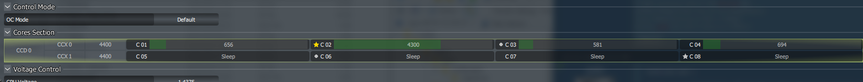

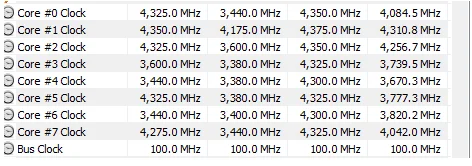

I think that's a pretty fair assumption, according to HWInfo cores 1-4 seem the best. That lines up with Ryzen master (see below) and my per CCX overclock. I'm still under but probably down to voltages.
