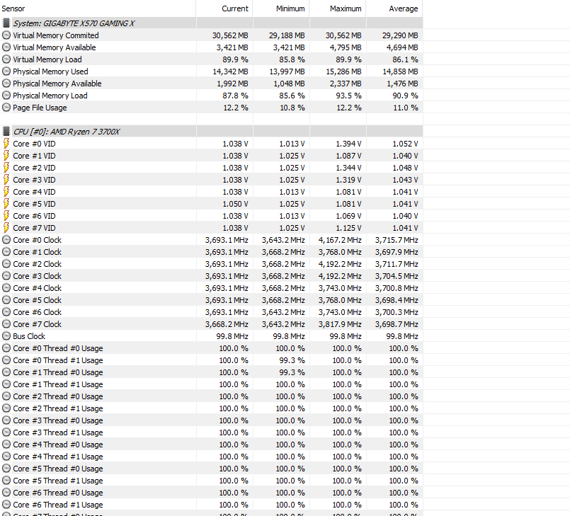

Been reading this with interest and thought I'd add my findings on it. I'm running prime and the CPU volt goes from around 1.5 to 1.35 under load (CPUs goes to about 4.15 Max under load and 4.3 outside of full load). All done under PBO.
here it is under load.

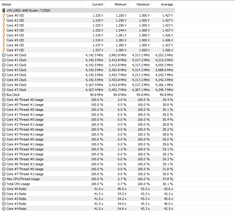

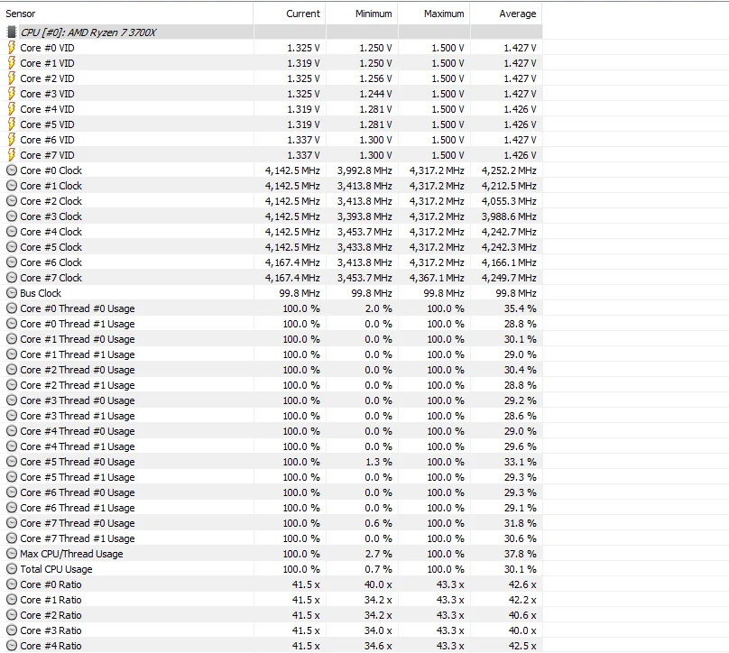

My temps are the same as above (3700X), they seem all over the place. I've lost the use of my M.2 slots on my Gigabyte Arous X470, F40 bios. At least now I can run my ram at 3200mhz.
ok, just as I post it goes a bit funky. CPU volt now 1.1, CPU speed 3.7 temp @ 75 after getting close to 95, then it all started dethrottling.

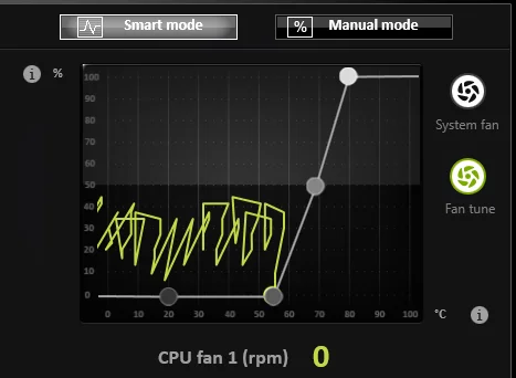

I have a Noctua NH-U12S and I've after much messing about I've just disabled the cooling fan until temps reach 65 degrees. The temperature and frequency fluctuations seem to be exactly the same, doesn't matter if the fan is 0% or 100%! See picture below.
