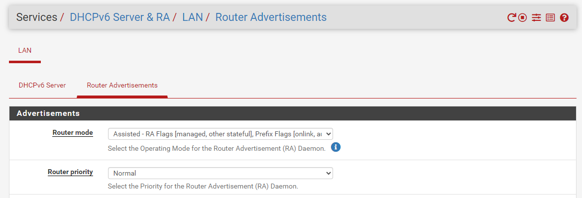

This is how everything else is configured:
