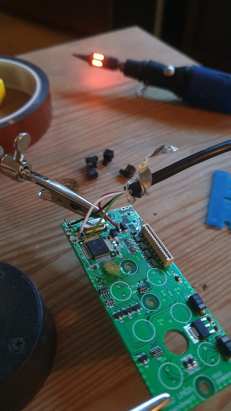

Then this week there was a keyboard that a friend managed to rip the Mini USB connector off of, then proceeded to cover the board in liquid metal and destroyed all of the traces around where the connector used to be. For this I just cut the end off of a spare usb and scratched back traces to see where stuff went:
I get these are not really proper repairs but still fun to work on and mess about with.
