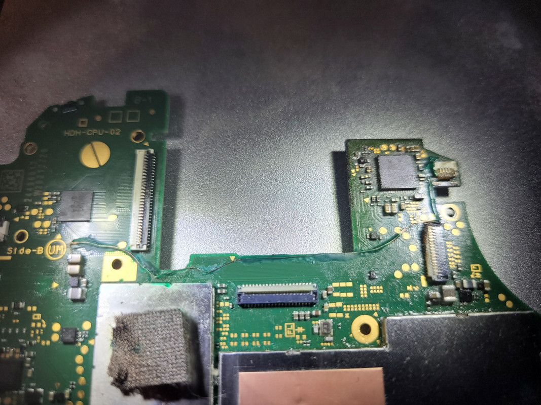

No cooling is a problem so next up I tackled the fan area, I popped a connector back on and 3 of the pins are fine, the top pin which is a 5v pwm is not, those test pads were totally rotten and the more I scraped, the more they just fell away, problem is they go through the board from here to somewhere else and they don't look connected to me.
After trying to get some solder down it was just falling away more so time for some jumpers, i went from the leg on the fan connector to the cap then over to where the test points were with a tiny bit that was still connected, tested it and as you can imagine no dice.
So I grabbed one of my donors and my meter and tested around the board for anything with continuity to that area, after a while I found it... run a quick jumper and tested it, look at that fan spinning
you can just about follow the wire down to the cap in this pic:
Time to make it more permanent, with some better soldered wires and some mask:
And this is now a fully working board, sure its a bit messy and there is a random wire running the length of the board plus a load of random rework around the audio IC but its a fully functioning switch once again.
