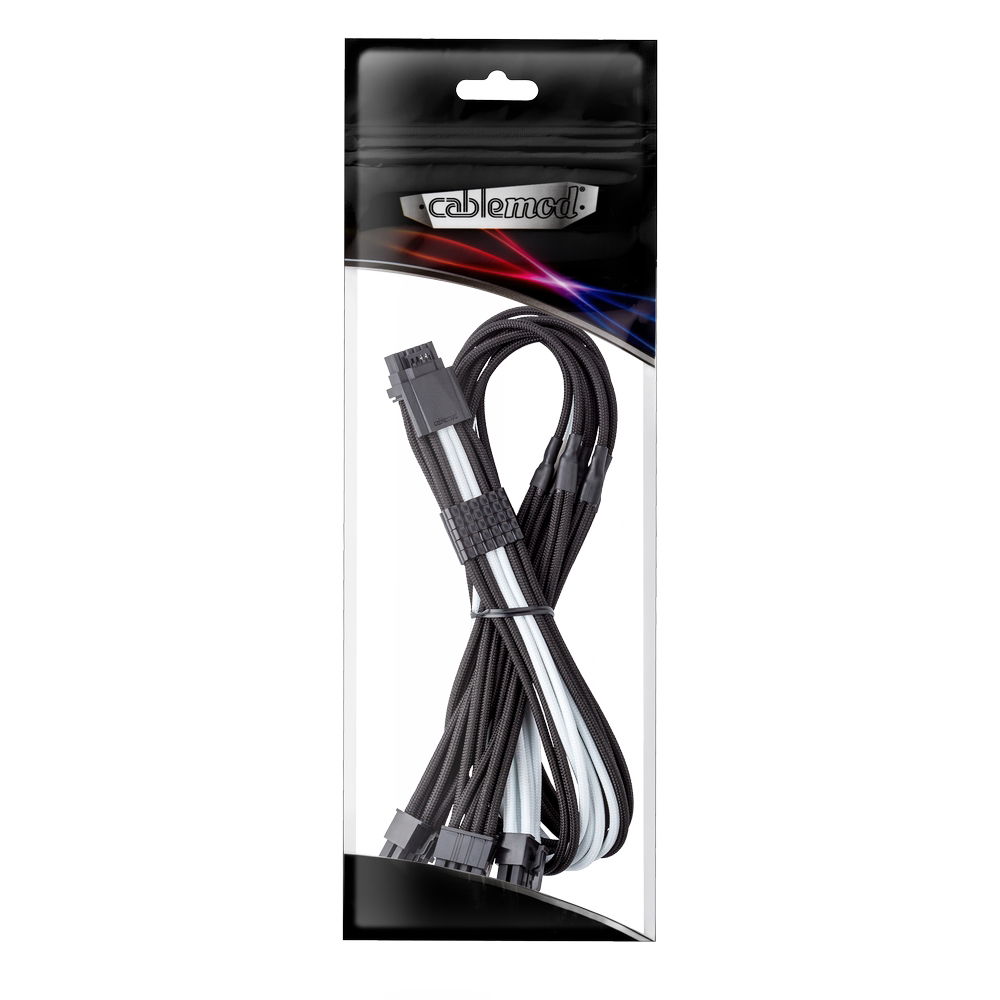

Corsair (specifically) and a couple of others are providing 600W PCIe 5.0 12VHPWR Type-4 PSU Power Cables that plug direct from GPU to the PSU (you don't need a new ATX 3.0 PCIe 5.0 compliant PSU).
So no more weird adapter with up to 4 cables.

What cable are people buying from cablemod? I've tried the configuration thing on there but am lost.
That’s for Corsair, chose which PSU you have and toggle colour and whether you want 3 or 4 8 pin PCIe connectors.
