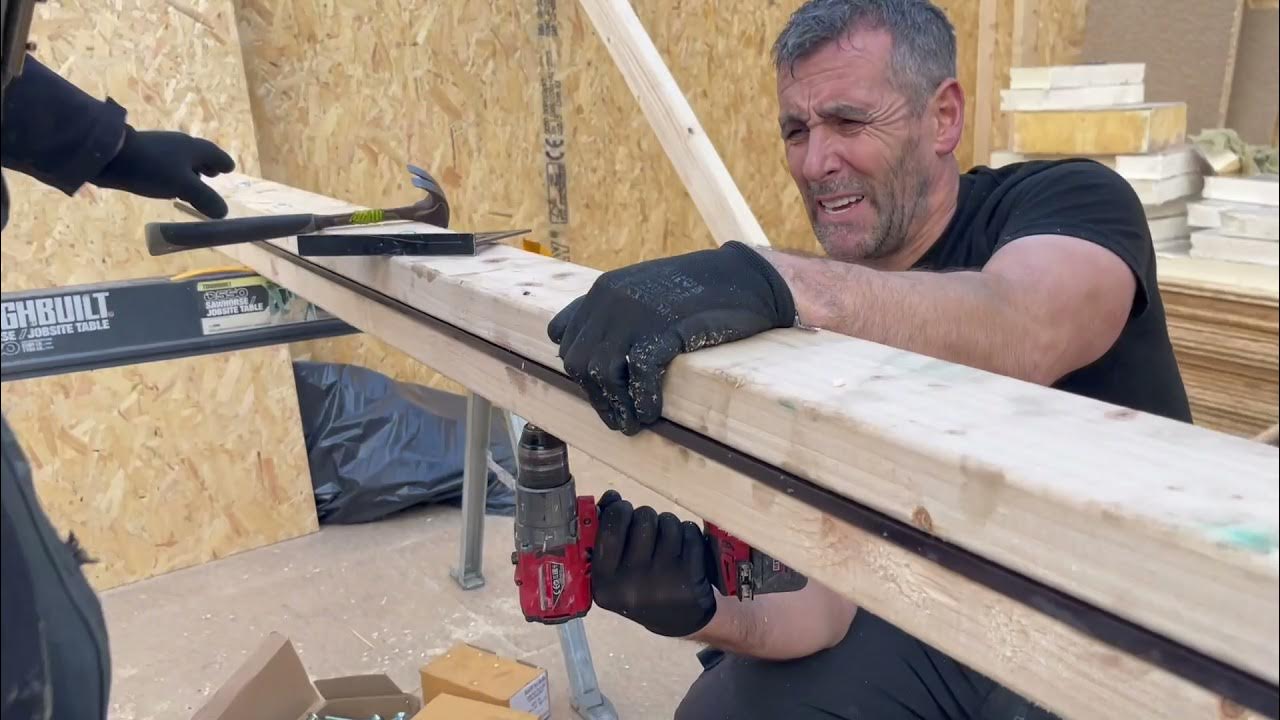

Could also just do a flitch plate above the door, doesn't look too hard
Yeah for a 2m span I'd chance a flitch. It depends on your labour cost, a box beam maybe fractionally less work.
Well my labour is me on parental leave or my nephew at 8quid an hour :D. Looks like itd only take an hour or so for a flitch. That company I posted previous wanted 120 quid delivery so I've contacted a local company to see what they can do. They said a box section they'd be getting in a 7.5m length so the wastage is monster!
