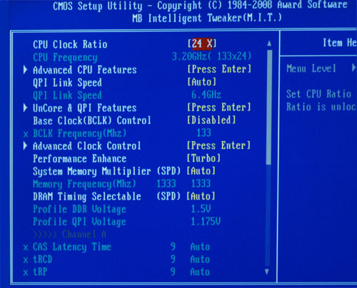

And another weird thing I see is that the BIOS actually detects my memory; it just don't enable some sticks. I can see that when I enter a "current status" screen. Here are two pics of two different dispositions.

2) The disposition for my sticks is 3-4-5-6. Whenever I try to use 1-2, I get lots of trouble and can't get over 16GB (as seen on screenshots). I guess this is some single/dual/triple channel stuff I frankly don't have the patience to learn right now.
3) BLK 133. Any other setup I've tried ends up with 16GB or 8GB. And this was the case with both i7-920 And Xeon X5650, and with any of this BIOS verions: f6, f10, f12, and f13.
4) Memory multipler auto (or 8x for 1066, or 10x for 1333).
5) CPU multiplier at turbo multiplier. Somehow, it doesn't like 20x and wants 21 for the 920 and 22 for the X5650.
With this, I got my current system at ~3GHz. That's surelly sub-standard for an overclocker community, and most likely improvable by investing time reading and configuring. Yet, it's ok for me, and I'm very happy with the upgrade.
