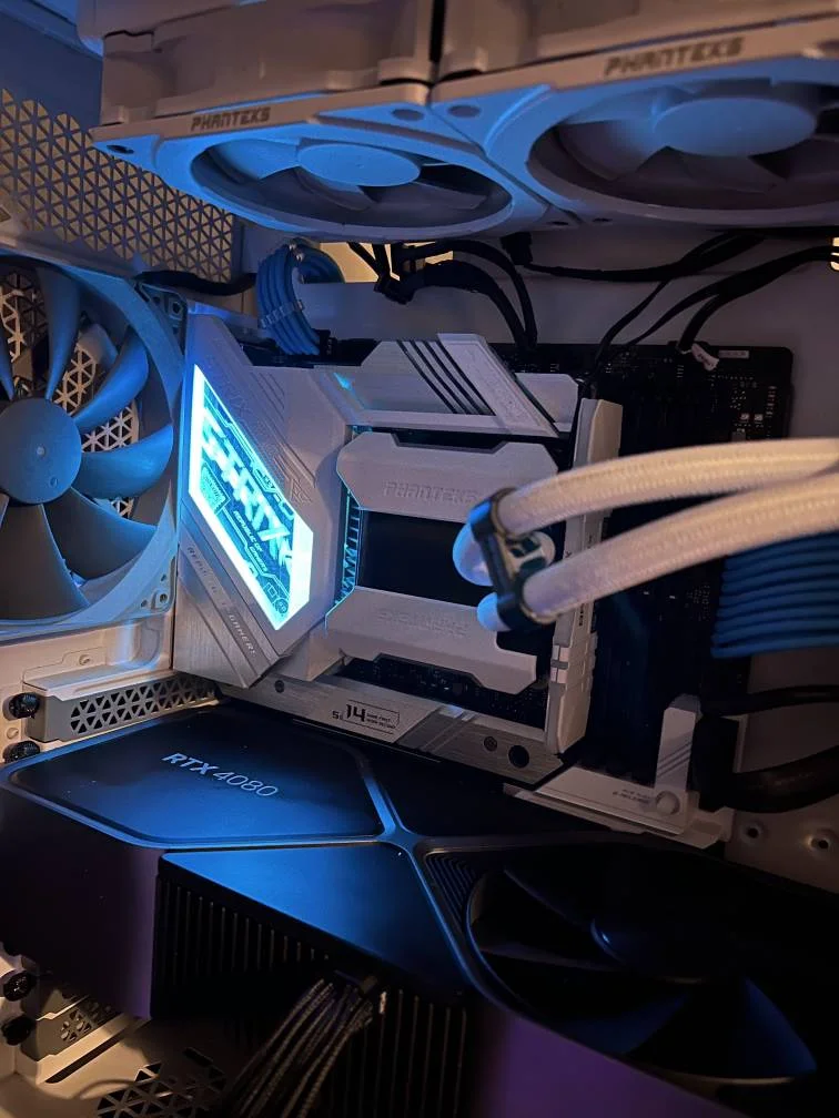

I purchased an 14900k from ocuk yesterday as I wanted to upgrade from my 12700k but I have come in to a problem, my pc wont boot now. I updated my bios on my Asus Z690-A Gaming D4 to the latest and installed the 14900k but the only thing what happens is the RGB lights up and thats it, no Qcode or anything when I press the power button. The best thing is putting my 12700k back in and still no boot, just RGB :(

The below picture is all what happens when power is connected

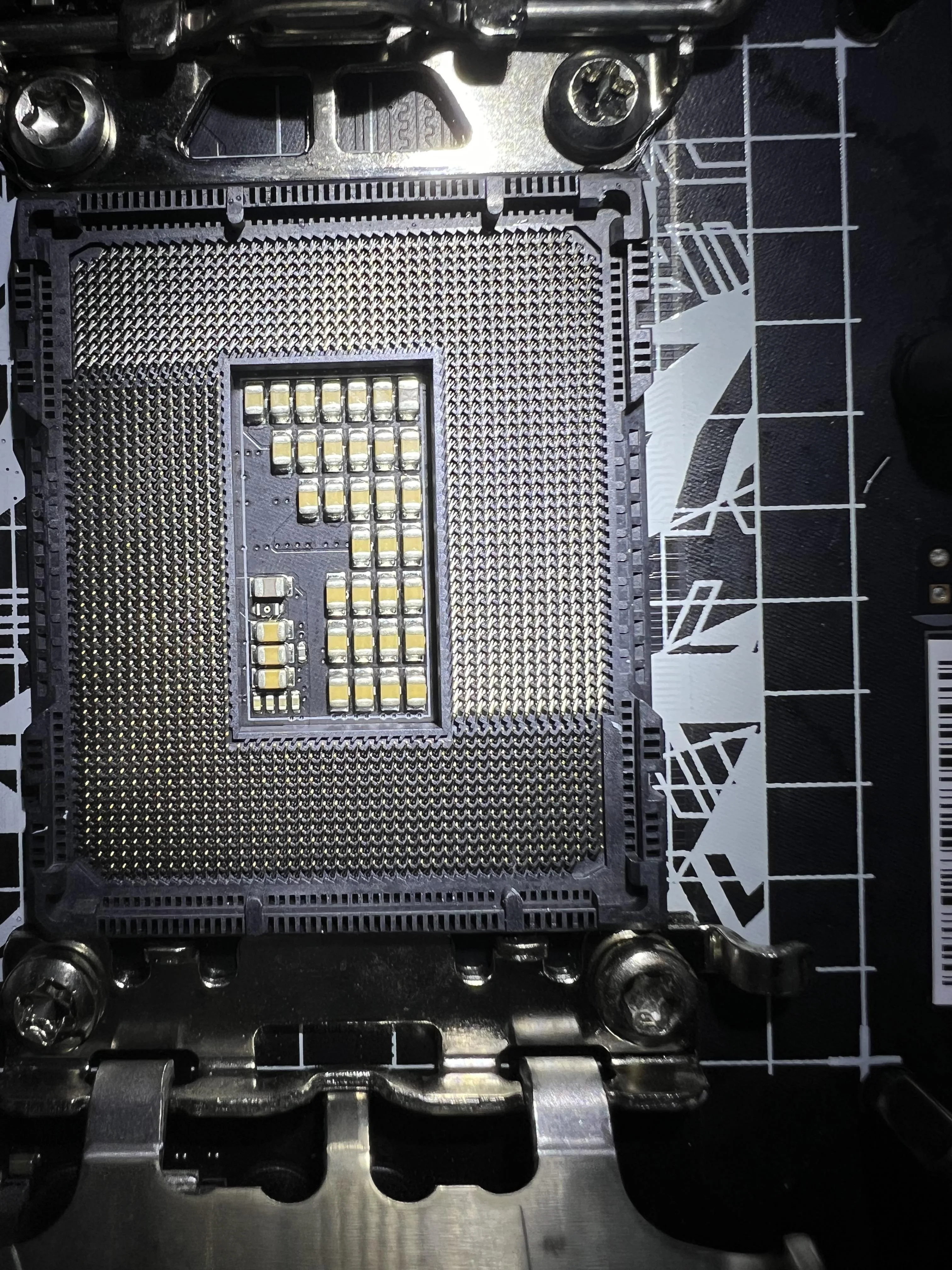

Did you check the CPU socket for bent pins, as suggested previously...?

Yes I did check the pins. I think the look ok
