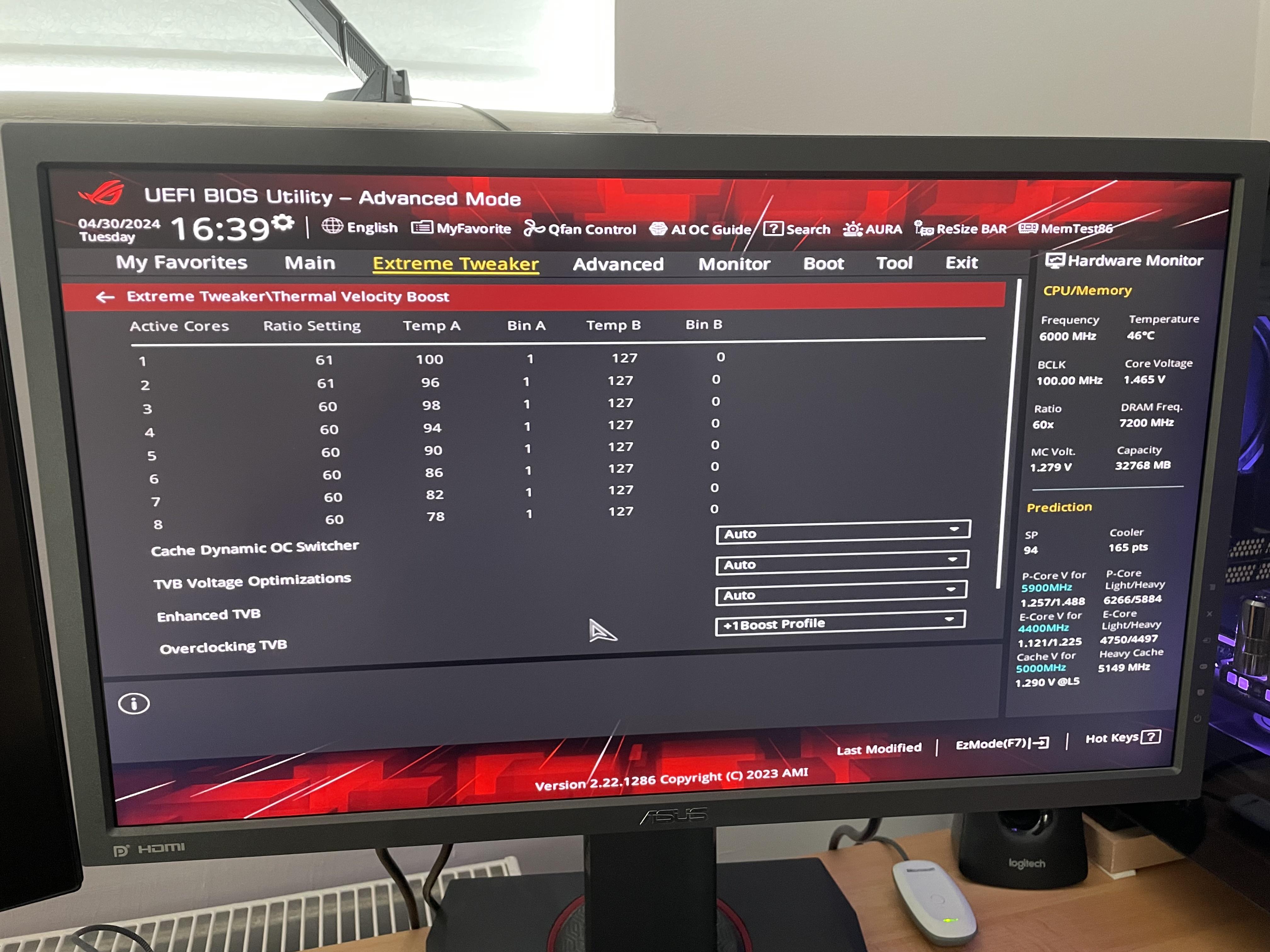

Had a bit of a chance to test some different settings with TVB today. I started by just using +1 boost as it automatically recommended higher temp offsets than +2. I imagine that is due to lower power requirements for not hitting 6.2, and instead targeting 6.1. To try and lower temps I reduced LLC level 6 to level 5, as I needed that for stability previously, but figured it may need less now. I kept working with the temp offsets until I could see 6GHz all core all of the time in the games I play the most and tried reloading all the shaders and running a few benchmarks to retest stability. Seems pretty good so far. Thanks for the suggestions! May not be 100% stable, but will see how I get on. I actually ended up getting a bit crazy on the temp offset and went to +34 up from 44C all core to 78C. Temps have definitely increased but it's not insane! The only thing that seems to bring down the clocks now are the momentary core temp jumps above 78C for a split second. Usually stays in the 50's and 60's.yep afaik you just adjust the offset to your liking but if its getting too hot and starts crashing just back it off a bit , mine hasn't caused me a single issue doing it this way even with the undervolt still in place . once you set the offset you can jump back into bios and the table will be updated with the offset numbers added on
Might not keep these settings, but please see this mental TVB setting and see what you think:
