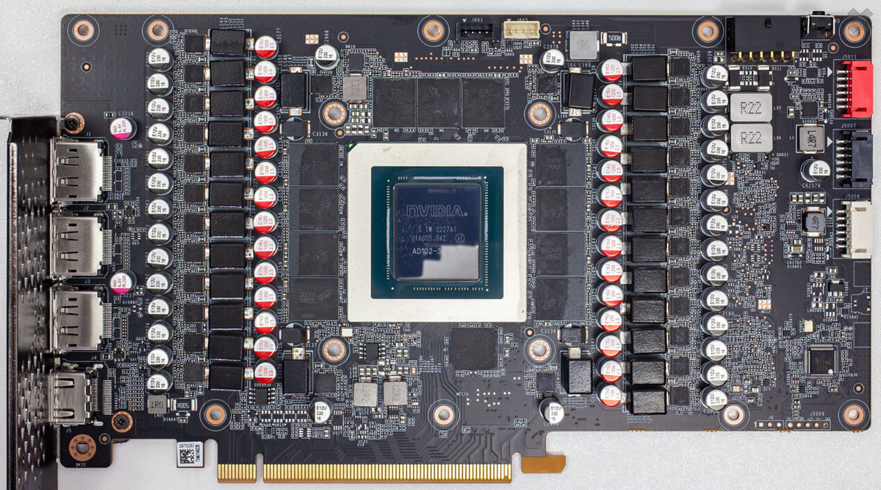

On a more positive note, I have found a really handy video from Buildzoid on coil whine: https://www.youtube.com/watch?v=4D6PKusyvUU
Based on this video, I took a look at the Techpowerup board photos. The 4090s with coil whine all have the inductor design BZ points out as suffering from coil whine. Very curiously the Zotac is using through-hole inductors, the kind that rarely have any coil whine according to BZ. However, I did notice that the intake inductors are the noisy kind. This is possibly why the Zotacs have no or minimal coil whine. If you're lucky the inductors that could make noise don't have any fitment issues and don't vibrate. But even if you're unlucky there's far fewer inductors to make the noise.
I'll be waiting on a restock of a Zotac 4090 going forward, any Zotac 4090 since they're all the same PCB I think.

Thanks for that, so a quick look at board designs....
Asus
2022-10-18-12-28-15-ASUS-TUF-RTX-4090-UNBOX-TEARDOWN-ROUGH-OVERCLOCK-TEST-OVER-3000mhz-AND-SOME-T.png
MSI
2022-10-18-12-29-58-MSI-Ge-Force-RTX-4090-Suprim-X-Review-Circuit-Board-Analysis-Tech-Power-Up-Mo.png
Zotac
2022-10-18-12-28-37-Zotac-Ge-Force-RTX-4090-Amp-Extreme-Airo-Review-Circuit-Board-Analysis-Tech-Po.png
Palit
2022-10-18-12-33-37-Palit-Ge-Force-RTX-4090-Game-Rock-OC-Review-Circuit-Board-Analysis-Tech-Power-Up.png

2022-10-18-13-25-08-Gigabyte-Ge-Force-RTX-4090-Gaming-OC-Review-Circuit-Board-Analysis-Tech-Power-U.png
Do they whine, looks like theyd scream.
