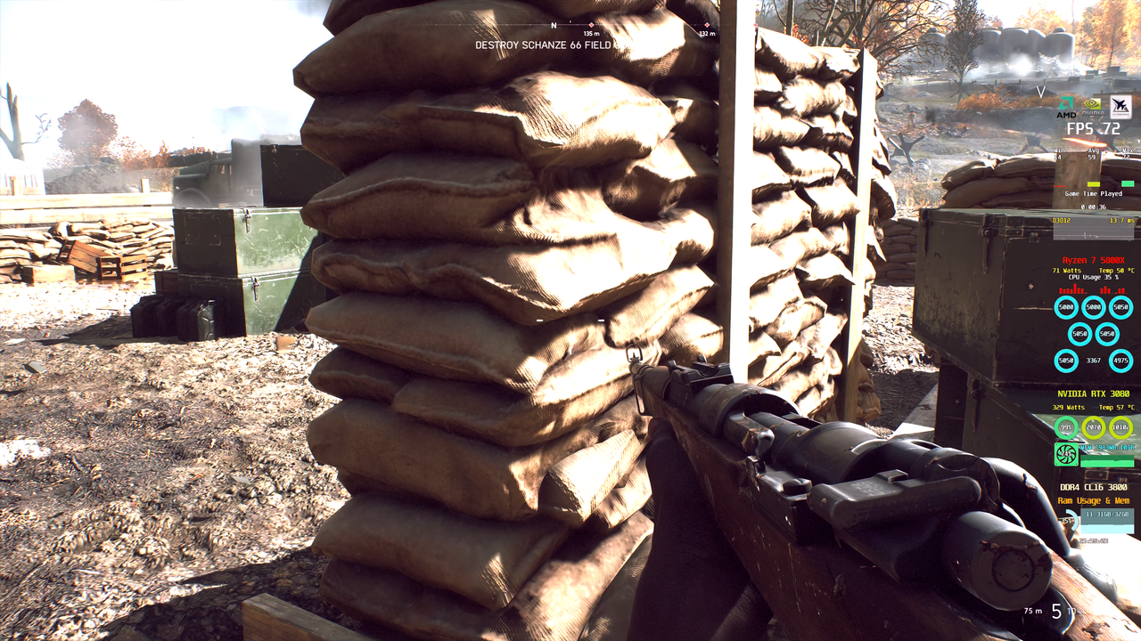

4.65Ghz all core 1.275V results in lower temps idle and load than using PBO. A good 10-15c lower load temps.
59c was the highest temp playing after an hour of COD Warzone
What game(s) would be a good stability / load test? I seem to remember Planet coaster battering my i7 4790k

out of interest what in game overlay is that ?
just zoomed in to see it's afterburner
Interested in this also.
Can afterburner be used to show cpu temps yet? Im using the beta which is supposed to show temps for for Ryzen 5000 cpus...but doesnt. Or I can’t find a way to
